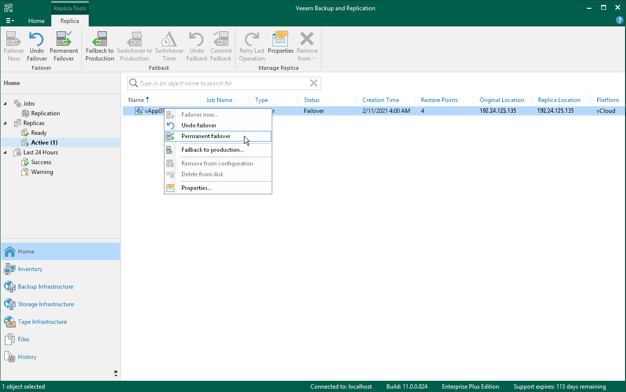

To perform permanent failover, do one of the following:
  • Open the Home view, in the inventory pane select Replicas. In the working area, select the necessary vApp and click Permanent Failover on the ribbon.
  • Open the Home view, in the inventory pane select Replicas. In the working area, right-click the necessary vApp and select Permanent Failover.

To perform a retry:
  1. Open the Home view, in the inventory pane, navigate to the Replicas > Active node.
  2. In the working area, select the necessary vApp and select Retry Permanent Failover on the ribbon. Alternatively, you can right-click the necessary vApp and select Retry permanent failover.
