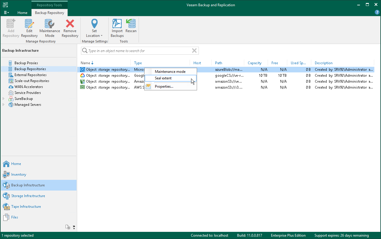

To put an object storage repository into seal mode, do the following:
- Open the Backup Infrastructure view.
- In the inventory pane, select the Backup Repositories node.
- In the working area, select an object storage repository and click Seal Extent on the ribbon or right-click an object storage repository and select Seal extent.
To remove the object storage repository from seal mode, select the extent and click Sealed on the ribbon or right-click the extent and select Sealed.
