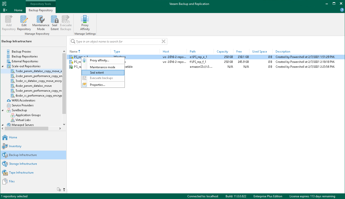

To put an extent into the seal mode:
- Open the Backup Infrastructure view.
- In the inventory pane, select the scale-out backup repository under the Scale-out Repositories node.
- In the working area, select the extent and click Seal extent on the ribbon or right-click the extent and select Seal extent.
To remove the extent from the seal mode, select the extent and click Sealed on the ribbon or right-click the extent and select Sealed.
