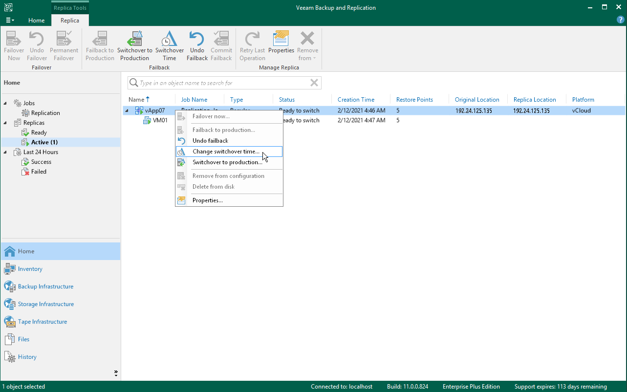

To change the time when the switch from replicas to production vApps must be performed:
  1. Open the Home view.
  2. In the inventory pane, navigate to the Replicas > Active node.
  3. In the working area, select the vApp in the Ready to switch state and select Switchover Time on the ribbon. Alternatively, you can right-click the necessary vApp and select Change switchover time.
If the switching time operation failed, you can retry this operation again. To perform a retry, in the working area, select the necessary vApp and select Retry Switchover Time on the ribbon. Alternatively, you can right-click the necessary vApp and select Retry switchover time.
