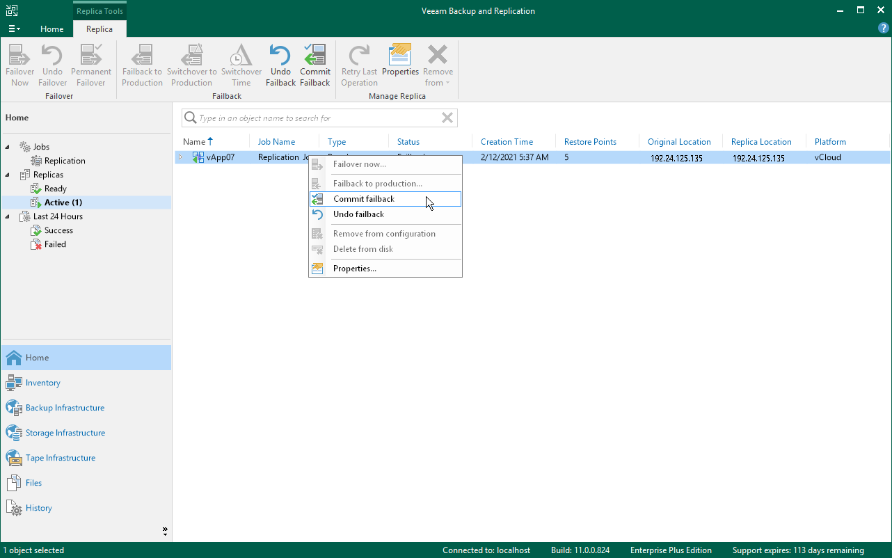

To commit failback, do one of the following:
- Open the Home view, in the inventory pane select Replicas. In the working area, select the necessary replica and click Commit Failback on the ribbon. In the displayed window, click Yes to confirm the operation.
- Open the Home view, in the inventory pane select Replicas. In the working area, right-click the necessary replica and select Commit Failback. In the displayed window, click Yes to confirm the operation.

- Open the Home view, in the inventory pane, navigate to the Replicas > Active node.
- In the working area, select the necessary vApp and select Retry Commit Failback on the ribbon. Alternatively, you can right-click the necessary vApp and select Retry commit failback.
