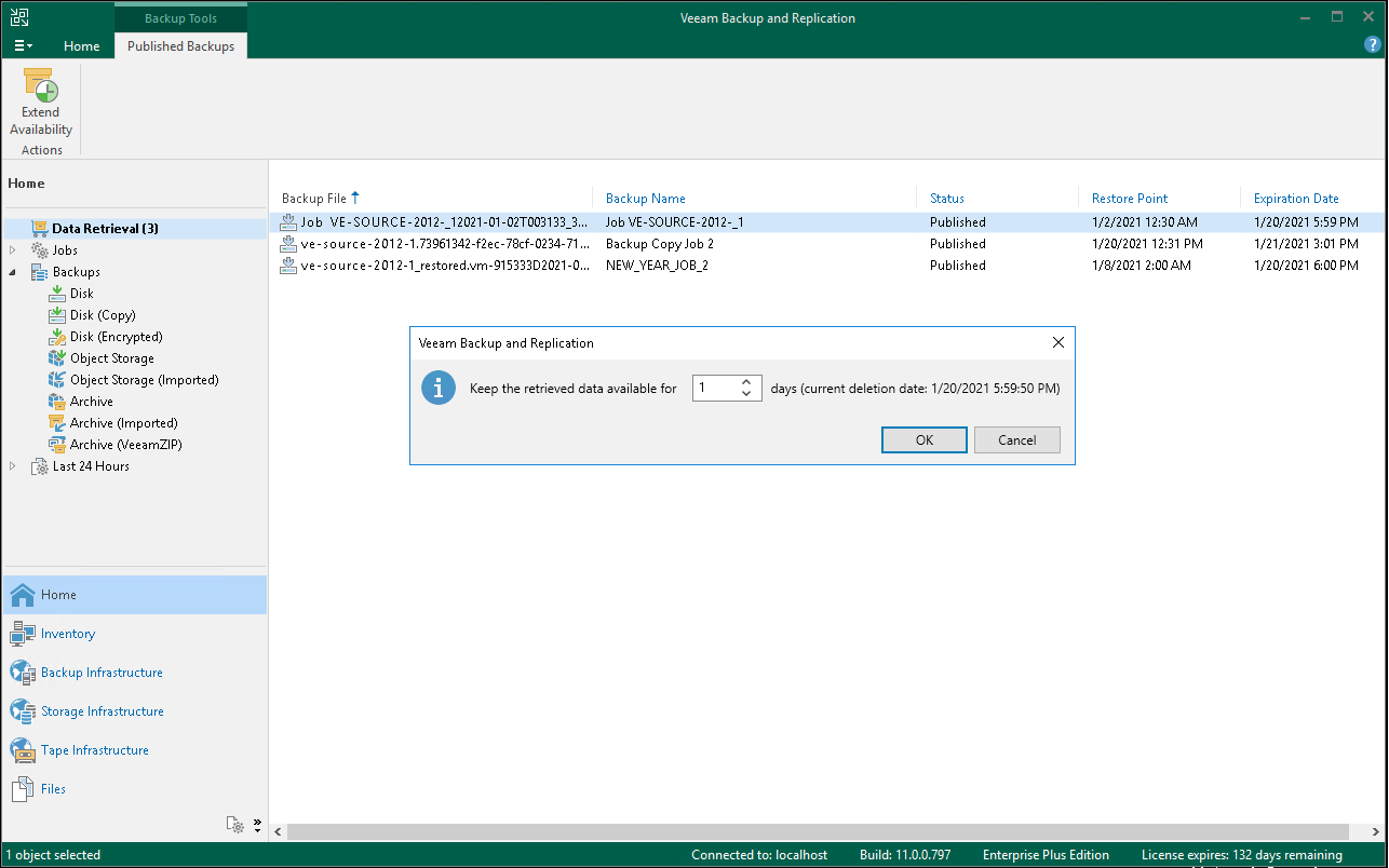

- Open the Home view. In the inventory pane select Data Retrieval. In the working area, select the retrieved backup file whose availability period you want to extend, and click Extend Availability on the ribbon. You will be prompted to select the number of days you want to add to the availability expiration time.
- Open the Home view. In the inventory pane select Archive. In the working area, select the backup job for whose retrieved files you want to extend availability and click Properties on the ribbon. In the Backup Properties window, click on Extend Availability Period. You will be prompted to select the number of days you want to add to current expiration time.
