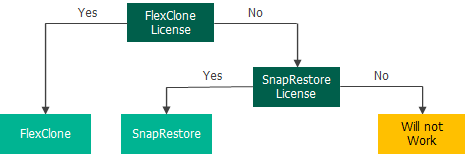

If the NetApp storage system operates in the cDot mode, you must have a FlexClone or SnapRestore license installed.
  • If you have a FlexClone license installed, Veeam Backup & Replication uses the FlexClone technology.
  • If you have a SnapRestore license installed, Veeam Backup & Replication uses the SnapRestore technology.
  • If neither FlexClone nor SnapRestore license is installed, VM data restore will fail.

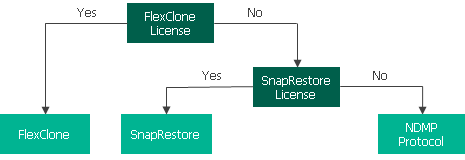

If the NetApp storage system operates in the 7-mode, you must have a FlexClone or SnapRestore license installed, or the NDMP protocol enabled.
Veeam Backup & Replication uses the following technologies for LUN clone creation:
  • If neither FlexClone nor SnapRestore license is installed, Veeam Backup & Replication uses the NDMP protocol. If the NDMP protocol is not enabled, VM data restore will fail.
[For Instant Recovery] Veeam Backup & Replication performs actual Instant Recovery only if a FlexClone license is installed. If the SnapRestore license is installed or the NDMP protocol is enabled, Veeam Backup & Replication performs entire VM restore instead of Instant Recovery. As a result, the restore process takes more time and may fail due to exceeding the default protocol timeout.
