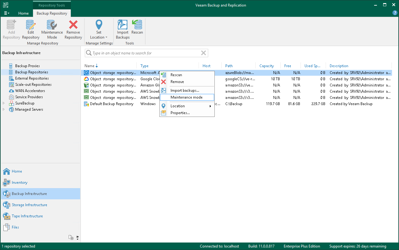

To put an object storage into the maintenance mode, do the following:
- Open the Backup Infrastructure view.
- In the inventory pane, select the Backup Repositories node.
- In the working area, select an object storage and click Maintenance mode on the ribbon or right-click an object storage and select Maintenance mode.
To remove the object storage repository from the maintenance mode, select the extent and click Maintenance Mode on the ribbon or right-click the extent and select Maintenance mode once again.
