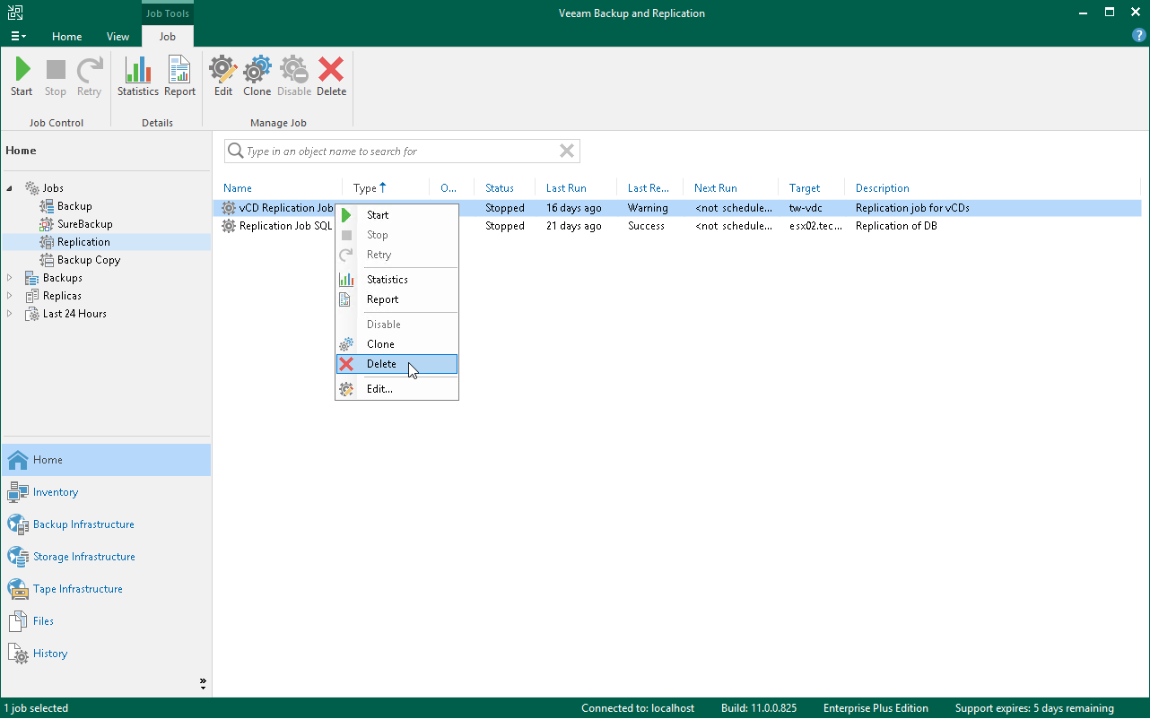

After you delete the job, the replicas created by this job are displayed under the Replicas node. Veeam Backup & Replication allows you to delete only disabled vCD replication jobs. You can also permanently delete a job from Veeam Backup & Replication and from the configuration database.
Veeam Backup & Replication allows you to delete only stopped vCD replication jobs.
To delete a vCD replication job:
- Open the Home view.
- In the inventory pane, navigate to the Jobs > Replication node.
- In the working area, select the necessary vCD replication job and select Delete on the ribbon. Alternatively, you can right-click the necessary vCD replication job and select Delete.
