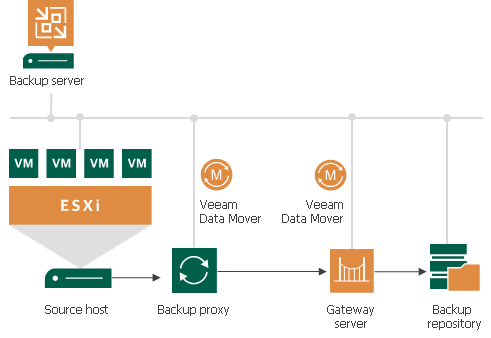

A gateway server is an auxiliary backup infrastructure component that “bridges” the backup server and backup repository. It can also "bridge" a source backup repository and a target backup repository in case of backup copy jobs. The gateway server is required if you deploy the following types of backup repositories in the backup infrastructure:
Such backup repositories cannot host Veeam Data Movers— Veeam components that establish a connection between a VMware backup proxy and backup repository (in case of backup jobs) or between backup repositories (in case of backup copy jobs). To overcome this limitation, Veeam Backup & Replication uses gateway servers.
In the backup infrastructure, a gateway server hosts the target Veeam Data Mover. Veeam Backup & Replication establishes a connection between the source Veeam Data Mover and target Veeam Data Mover, and transports data from/to backup repositories through gateway servers.
