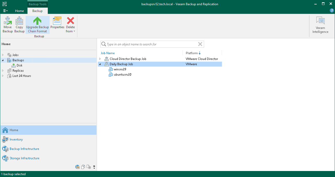

To change the backup chain format from per-machine with single metadata file to per-machine with separate metadata files, use the upgrade functionality:
  1. Open the Home view.
  2. In the inventory pane, select the Backups node.
  3. In the working area, select the necessary jobs. Note that the selected jobs must be targeted to the same repository.
  4. Right-click one of the selected jobs and click Upgrade backup chain format. Alternatively, click Upgrade Backup Chain Format on the ribbon.
Veeam Backup & Replication will generate new metadata files for the existing backups. After the upgrade, the job will continue the backup chain and create per-machine backups with separate metadata files.
