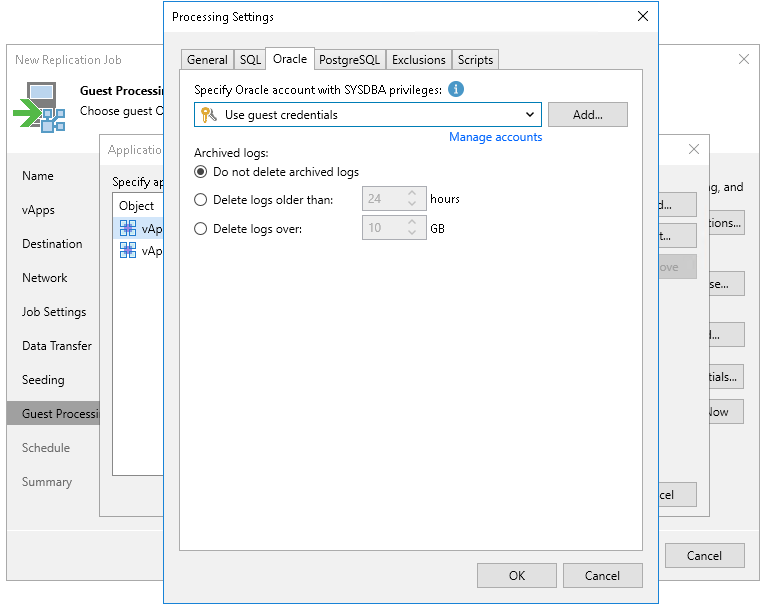

To configure how Veeam Backup & Replication must process archive logs of an Oracle server:
  1. In the Processing Settings window, switch to the Oracle tab.
  2. From the Specify Oracle account with SYSDBA privileges drop-down list, select a user account that Veeam Backup & Replication will use to connect to the Oracle databases. The account that you plan to use must have privileges described in section Permissions.
You can select Use guest credentials from the list of user accounts. In this case, Veeam Backup & Replication will use the account specified at the Guest Processing step of the wizard to access the VM guest OS and connect to the Oracle databases.
  1. In the Archived logs section, specify how to process archived logs:
  • If you want to preserve archived logs on the VM guest OS, select Do not delete archived logs. When the replication job completes, the non-persistent runtime components or persistent components will not truncate transaction logs.
It is recommended that you select this option for databases where the ARCHIVELOG mode is turned off. If the ARCHIVELOG mode is turned on, archived logs may grow large and consume all disk space.

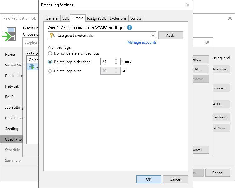

  • If you want to delete archived logs older than <N> hours, select Delete logs older than <N> hours and specify the number of hours.
  • If you want to delete archived logs larger than <N> GB, select Delete logs over <N> GB and specify the size. The specified size refers to the log size of each database, not all databases on the selected Oracle server.
The non-persistent runtime components or persistent components running on the VM guest OS will wait for the replication job to complete successfully and then trigger transaction logs truncation using Oracle Call Interface (OCI). If the job does not manage to replicate the Oracle VM, the logs will remain untouched on the VM guest OS until the next start of the non-persistent runtime components or persistent components.
