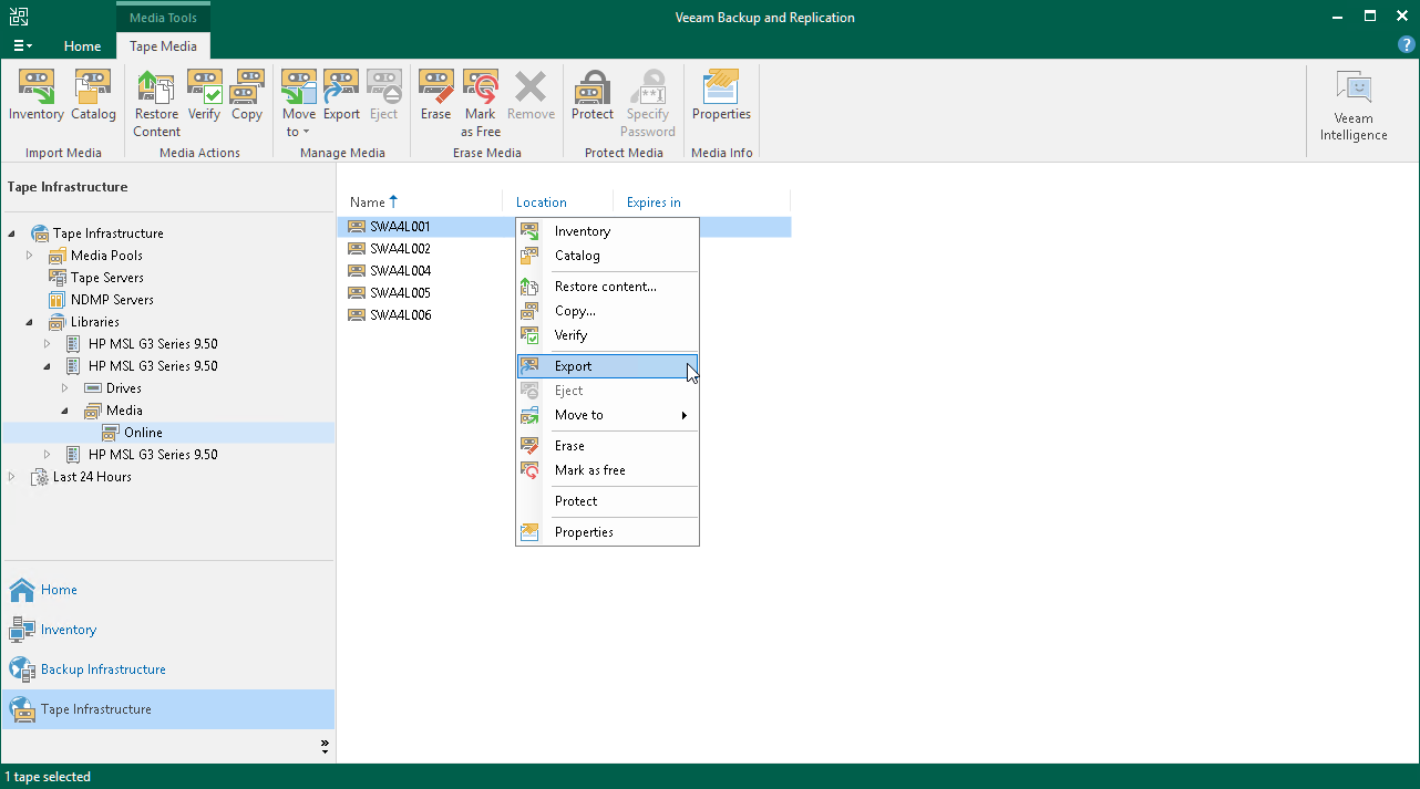

  1. Open the Tape Infrastructure view.
  2. Navigate to the list of tapes either under Media Pools or under Libraries > LibraryName node > Media > Online.
  3. Select a tape you want to export and click Export on the ribbon. Alternatively, you can right-click selected tape and select Export from the shortcut menu.
