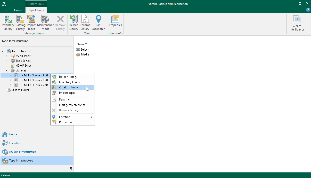

Cataloging Tape Libraries
To catalog a whole tape library:
  1. Open the Tape Infrastructure view.
  2. Expand the Libraries node and select the library you want to catalog.
  3. Click Catalog Library on the ribbon. Alternatively, you can right-click the tape library and select Catalog library.

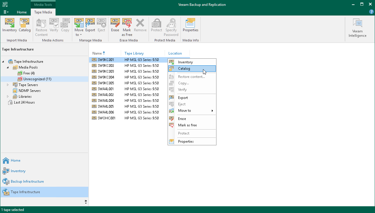

To catalog selected tapes:
  2. Navigate to the list of tapes either under the Media Pools or under the Libraries > LibraryName node > Media.
  3. Select the necessary tapes in the list and click Catalog on the ribbon. Alternatively, you can right-click the selected tapes and choose Catalog.
Once the catalog job finishes, Veeam Backup & Replication ejects the tape to a library slot to prevent the tape from being accidentally overwritten. However, this does not apply to standalone tape drives.
The catalog log will display job session results. To access the catalog session details, you can open the History view and locate the necessary session under the Jobs > Tape node.
