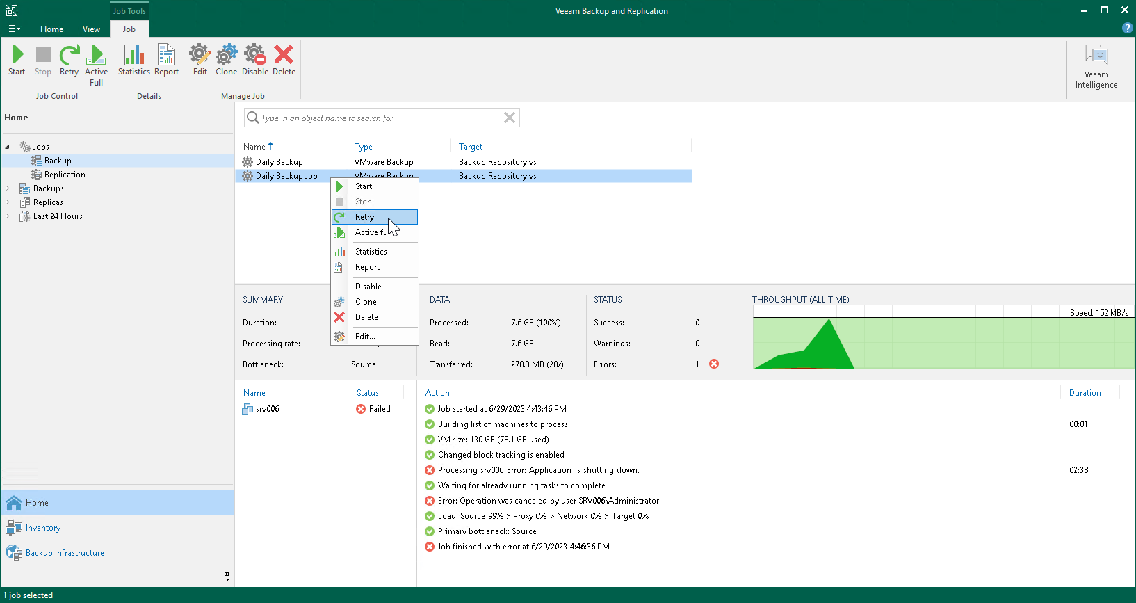

To perform retry for all workloads in a backup job:
  1. Open the Home view.
  3. In the working area, select the necessary job and click Retry on the ribbon. Alternatively, you can right-click the job and select Retry.

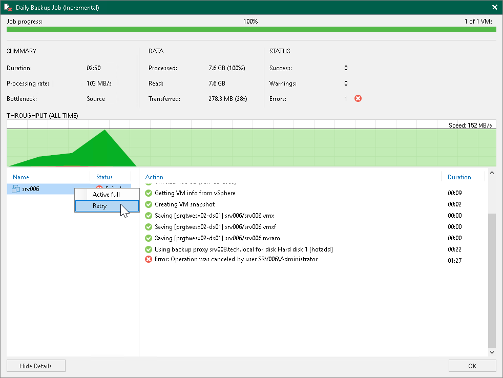

To perform retry for individual workloads:
  1. Open real-time statistics or sessions results of the job.
  2. Select failed workloads for which you want to perform retry.
  3. Right-click one of the selected workloads and click Retry. Note that you will be able to launch retry for other workloads in the job only after retry finishes for the selected workloads.
You can perform retry for individual workloads only if their backups are per-machine with separate metadata files.
