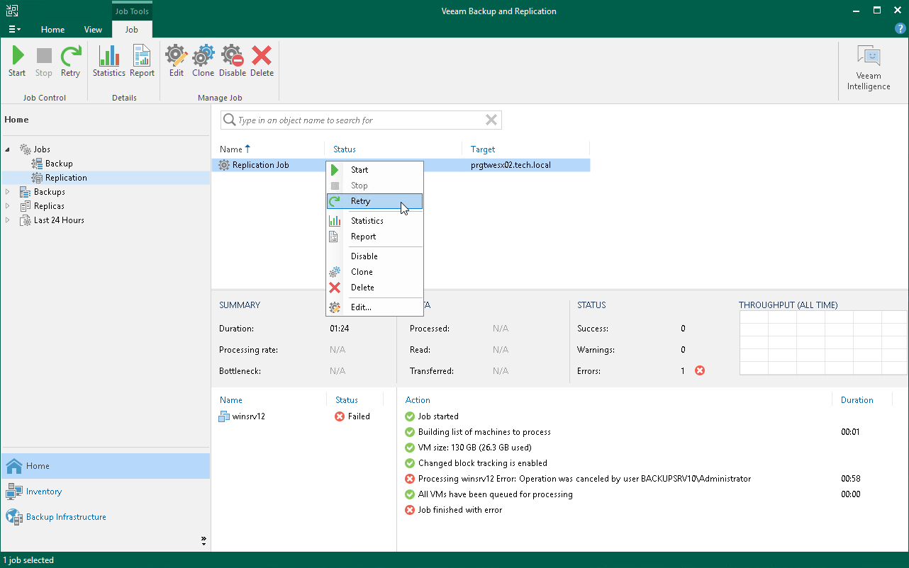

To retry a failed replication job:
  1. Open the Home view.
  2. In the inventory pane, navigate to the Jobs > Replication node.
  3. In the working area, select the necessary replication job and select Retry on the ribbon. Alternatively, you can right-click the necessary replication job and select Retry.
