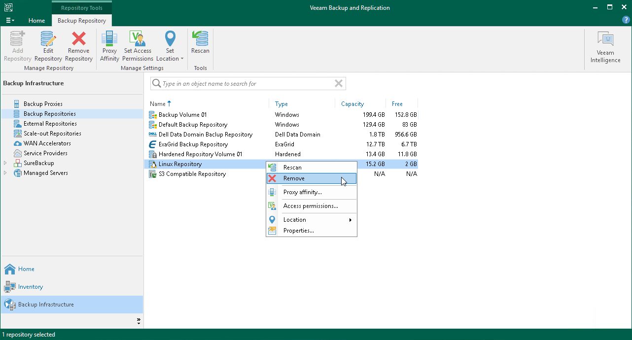

  1. Open the Backup Infrastructure view and remove the Linux backup repository from the backup infrastructure.
