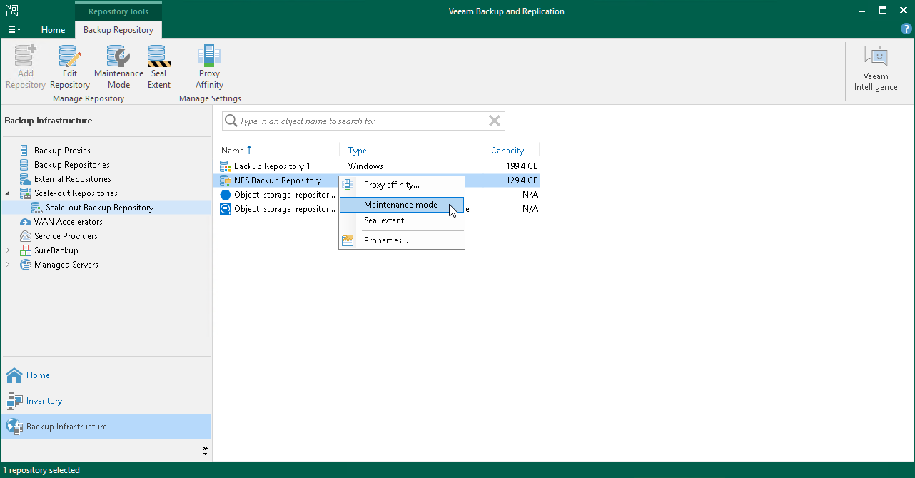

Putting Extent to Maintenance Mode
To put an extent into the Maintenance mode:
  2. In the inventory pane, select the scale-out backup repository under Scale-out Repositories.
  3. In the working area, select the extent and click Maintenance Mode on the ribbon or right-click the extent and select Maintenance mode.
To remove the extent from the Maintenance mode, select the extent and click Maintenance Mode on the ribbon or right-click the extent and select Maintenance mode once again.
