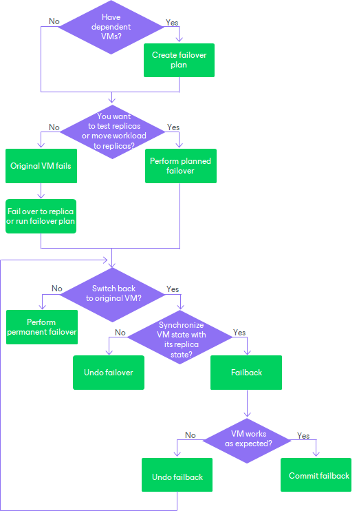

Veeam Backup & Replication supports failover and failback operations for one VM and for several VMs. In case one or several hosts fail, you can use batch processing to restore operations with minimum downtime.
The following scheme can help you decide which steps are preferable when you fail over to a replica.
Failover and failback — When use
