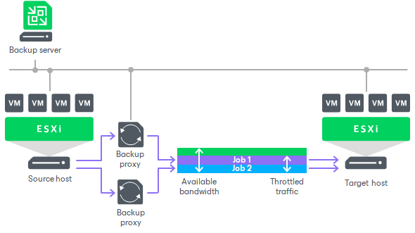

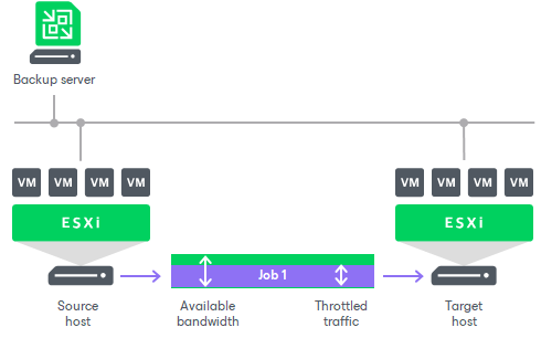

When several jobs that fall into the same network rule run simultaneously, Veeam Backup & Replication equally splits the throttled traffic between them. For example, if two jobs run at a time, each job gets half of the throttled traffic. Once one job finishes, the other gets the entire bandwidth allowed by the rule.

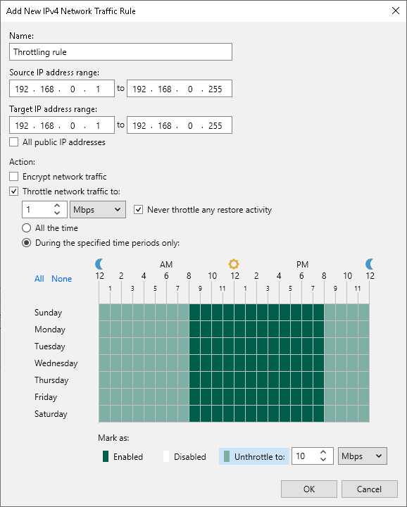

Configuring Traffic Throttling
To configure traffic throttling settings in a rule:
  1. From the main menu, select Network Traffic Rules.
  2. In the Global Network Traffic Rules window, click Add and select an IPv4 or IPv6 rule. Note that you can add the IPv6 rule only if IPv6 communication is enabled as descried in IPv6 Support.
  3. In the Name field, specify a name for the rule.
  4. In the Source IP address range section, specify a range of IP addresses for the backup infrastructure components on the source site.
  5. Specify ranges of IP addresses on the target site:
  • To specify IP addresses of the backup infrastructure components, use the Target IP address range section.
  • To throttle traffic to public networks, select the All public IP addresses check box. Public networks are all IPv4 networks whose IP ranges differ from 10.0.0.0/8, 172.16.0.0/12, 192.168.0.0/16 and all IPv6 networks whose IP ranges differ from fc00::/7.
  1. Select the Throttle network traffic to check box.
  2. In the Throttle network traffic to field, specify the maximum speed that must be used to transfer data from source to target.
  3. If you want to throttle traffic during the restore activities, clear the Never throttle any restore activity check box.
The Never throttle any restore activity check box applies only to the restore methods listed in the Infrastructure Components table.
  1. In the section under the Throttle network traffic to field, specify time periods when traffic is throttled:
  • Select the All the time option if traffic throttling rules must be applied continuously.
  • Select During the specified time periods only and use the diagram under it to mark the periods when the traffic must be throttled or not. Use the Unthrottle to field to increase or decrease the throttling limit for specific hours and days.
