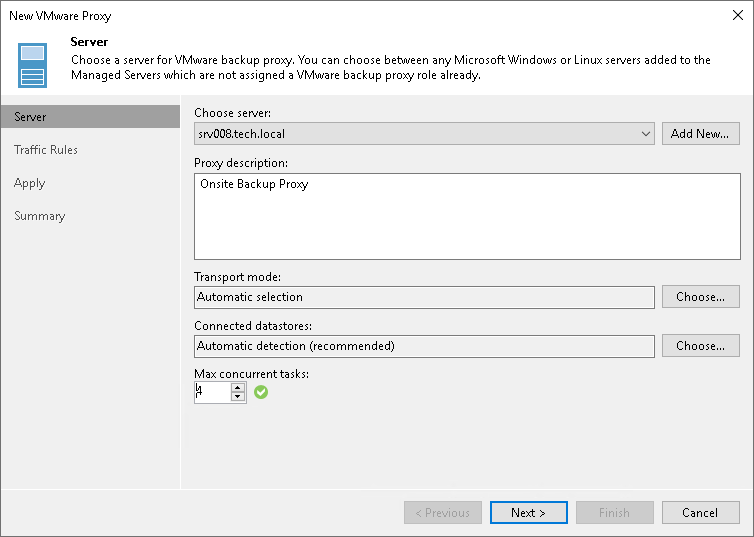

We recommend that you define the maximum number of concurrent tasks depending on the number of CPU cores available on the VMware backup proxy. To calculate the optimum limit, we recommend that you follow the rule: not more than 2 tasks per 1 CPU core.
To limit the number of concurrent tasks on a VMware backup proxy, you must define the Max concurrent tasks setting for the backup proxy.

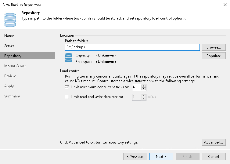

We recommend that you define the maximum number of concurrent tasks based on the number of CPU cores and RAM available on the backup repository. To calculate the optimum limit, follow the rule: not more than 2 tasks per 1 CPU core, not less than 1 GB RAM for each concurrently processed machine disk and not less than 4 GB RAM for each concurrently processed unstructured data source (in case of deduplicating storage appliances, up to 8 GB RAM). In case of shared folder backup repositories, the same amount of resources is required for gateway servers.
To limit the number of concurrent tasks in a backup repository, you must enable the Limit maximum concurrent tasks to <N> option on the backup repository and define the necessary task limit.
