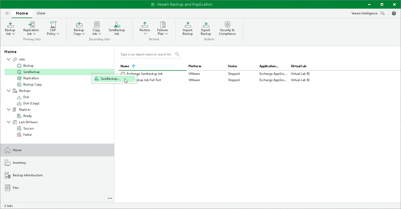

  • Open the Home view. On the Home tab, click SureBackup Job on the ribbon.
  • Open the Home view. In the inventory pane, right-click SureBackup under Jobs and select SureBackup.

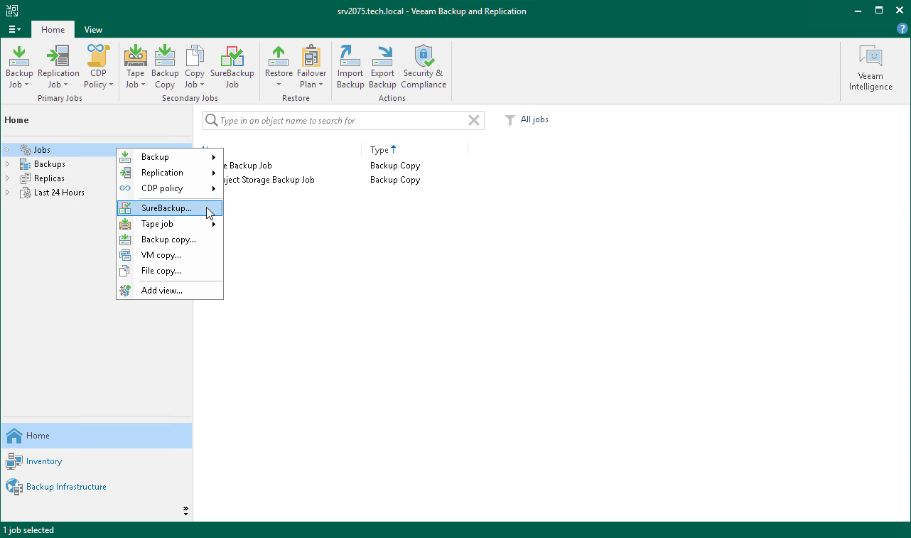

You can use this method if you already have at least one SureBackup job. If there are no SureBackup jobs, the SureBackup node will not be displayed in the inventory pane. In this case, you can right-click Jobs in the inventory pane and select SureBackup.
