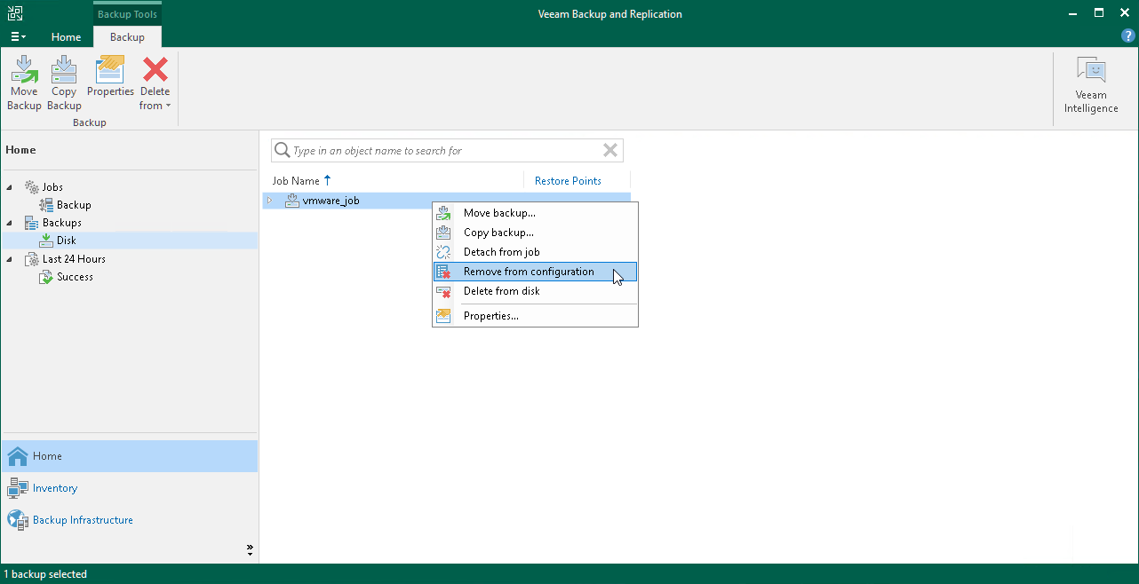

  2. Remove the backup files stored on all Linux extents from the backup configuration.To do this, go to the Backups > Disk node and select a backup file. Hold [Ctrl] and right-click the file. Then, select Remove from configuration.
Removing backups from configuration is designed for experienced users only. It is strongly recommended to create encrypted configuration backup before performing this operation.

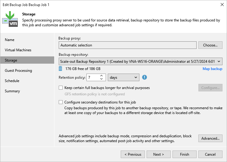

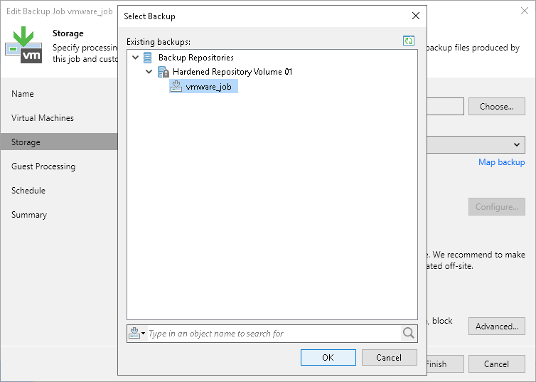

  1. Go to the Jobs node and edit the jobs associated with the SOBR. At the Storage step of the wizard, select the SOBR from the backup repository list.
Upgrading Performance Extent to Hardened Repository
Select Map Backup and map the job to the corresponding imported backup. Finish the wizard to apply changes. Repeat this process for each backup job using the SOBR.
