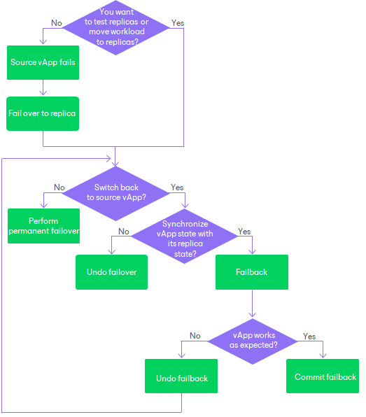

  • Perform failover
When you perform failover, you shift all processes from the source vApp in the production organization VDC to the replica in the DR organization VDC. Failover is an intermediate step that needs to be finalized: you can perform permanent failover, perform failback or undo failover.
  • Perform permanent failover
When you perform permanent failover, you permanently switch from the source vApp to a replica and use this replica as the production vApp. The source vApp is excluded from VMware Cloud Director replica processing.
  • Undo failover
When you undo failover, you switch back to the source vApp and discard all changes made to the replica while it was running. For example, you can use the undo failover scenario if you have failed over to the replica for testing and troubleshooting purposes, and you do not need to synchronize the source vApp state with the current state of the replica.
  • Perform failback
When you perform failback, you switch back to the source vApp and send to the source vApp all changes that took place while the replica was running. If the source organization VDC is not available, you can recover a vApp with the same configuration as the source vApp and switch to it.
When you perform failback, changes are only sent to the source or recovered vApp but not published. You must test whether the source or recovered vApp works with these changes. Depending on the test results, you can do the following:
  • Commit failback. When you commit failback, you confirm that the source or recovered vApp works as expected and you want to get back to it.
  • Undo failback. When you undo failback, you confirm that the source or recovered vApp is not working as expected and you want to get back to the replica.
The following scheme can help you decide which steps are preferable when you fail over to a replica.
Failover and failback scheme
