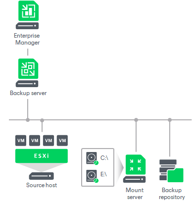

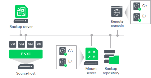

Restoring Files from Backups
When you restore files from backups that reside in the backup repository, Veeam Backup & Replication creates a mount point on the following machines:
  • Mount server associated with the backup repository on which the backup file resides. Veeam Backup & Replication uses this mount point when the restore process starts and allows you to browse the VM file system and restore files.
  • Veeam Backup & Replication console. Veeam Backup & Replication uses this mount point only for the mount to console functionality, that is, while you use Microsoft Windows File Explorer to view files and folders of the backed-up VM. For more information, see Open Files in Microsoft Windows Explorer.
Mount Points and Restore Scenarios
Backup files on HPE StoreOnce are locked exclusively by a restore task. For this reason, Veeam Backup & Replication uses only one mount point on the backup server or Veeam Backup & Replication console machine for backups on HPE StoreOnce.

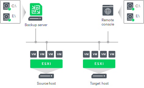

Restoring Files from Replicas
When you restore files from a VM or CDP replica, Veeam Backup & Replication creates a mount point on the following machines:
  • Backup server. Veeam Backup & Replication uses this mount point while the restore process and allows you to browse the VM file system and restore files.
  • Veeam Backup & Replication console. Veeam Backup & Replication uses this mount point only for the mount to console functionality, that is, while you use Microsoft Windows File Explorer to view files and folders of the VM replica. For more information, see Open Files in Microsoft Windows Explorer. If you also restore files to the console or a shared folder (use the Copy to command) while the mount to console functionality is enabled, Veeam Backup & Replication uses the same mount point for restore. If you launch other restores, Veeam Backup & Replication uses the backup server as a mount point.

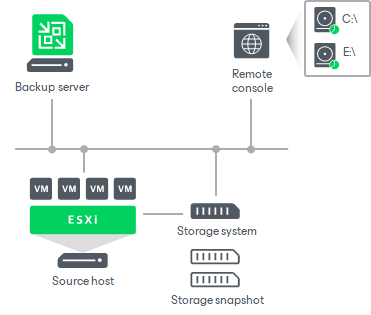

Restoring Files from Storage Snapshots
When you restore files from storage snapshots, Veeam Backup & Replication uses one mount point on the backup server or Veeam Backup & Replication console machine.
