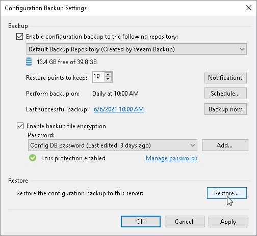

  2. From the main menu of the Veeam Backup & Replication console, select Configuration Backup.
  3. In the Restore section, click Restore to launch the Configuration Database Restore wizard.
Migrating Veeam Backup & Replication to Another Backup Server
Loss protection disabled warning is safe to ignore if you do not have Veeam Backup Enterprise Manager installed, your backup server is not registered with Veeam Backup Enterprise Manager server, or your system administrator chose not to enable loss protection functionality.

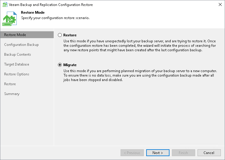

  1. At the Restore Mode step of the wizard, select Migrate.
Before migrating the configuration backup, Veeam Backup & Replication performs an additional check. If the configuration backup does not meet the requirements, Veeam Backup & Replication will offer you an option to switch to the Restore mode.

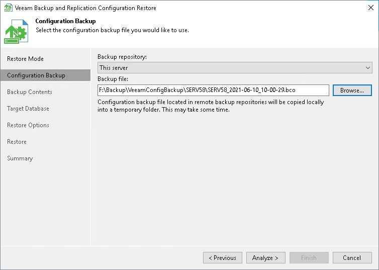

  1. At the Configuration Backup step of the wizard, specify the backup file of the configuration database
  1. From the Backup repository drop-down list, select This server.
  2. Click Browse to specify the backup file location.
This backup file has been created in Step 3. You must copy the backup file to the target Veeam Backup & Replication server beforehand.
