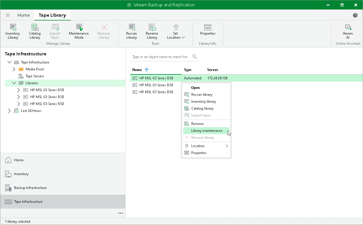

To switch a tape library to the maintenance mode:
  1. Open the Tape Infrastructure view.
  2. Navigate to the list of tape libraries under Libraries.

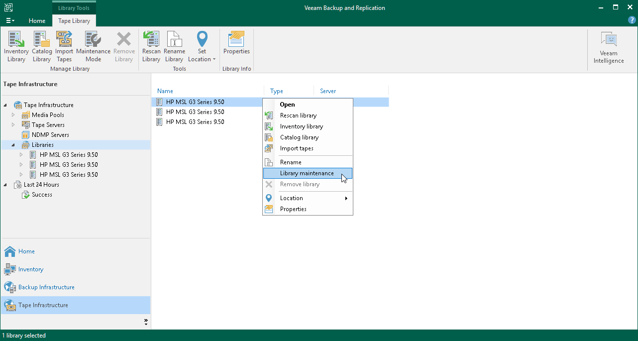

  3. Select a tape library you want to switch to the maintenance mode and click Maintenance Mode on the ribbon. Alternatively, you can right-click the selected tape library and select Library maintenance from the drop-down menu. Or you can open the tape library properties and select the Maintenance mode check box.
The tape library will stay in the maintenance mode until you manually disable it by performing the same actions like you did when enabling it.
