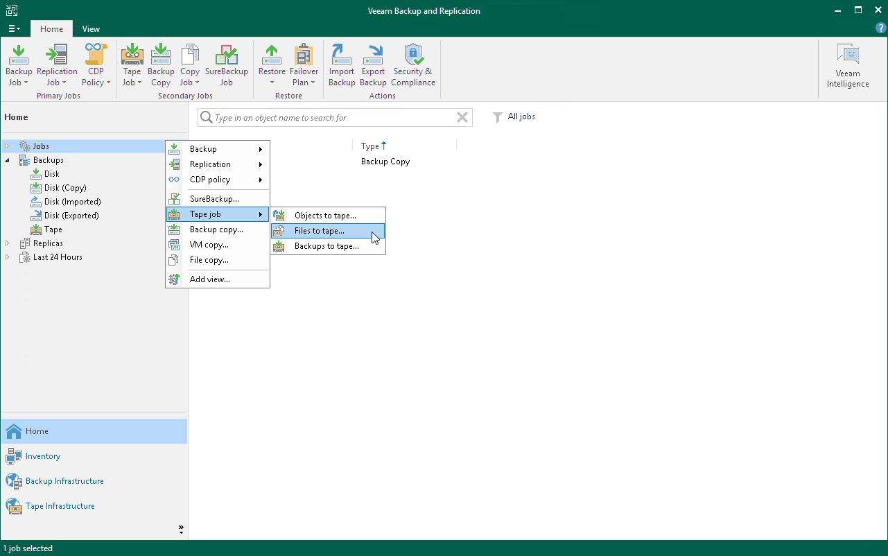

Step 1. Launch New File to Tape Job Wizard
To run the New File to Tape Job wizard, do either of the following:
  • On the Home tab, click Tape Job and select Files.
  • Open the Home view, right-click the Jobs node and select Tape Job > Files to Tape.
Alternatively, you can:
  • Open the Files view, browse to the necessary files, select the files and choose Add to Tape Job > New job from the ribbon menu.
  • Open the Files view, browse to the required files, right-click the necessary files and choose Add to Tape Job > New job.
