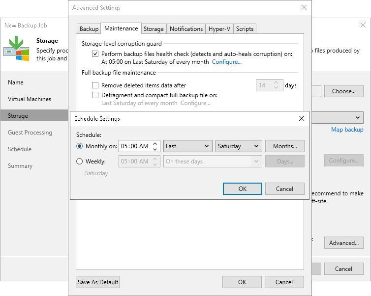

To run the health check periodically, you must enable the Perform backup files health check option in the backup job settings and define the health check schedule. By default, the health check is performed at 5:00 on the last Saturday of every month. You can change the schedule and run the health check weekly or monthly on specific days.

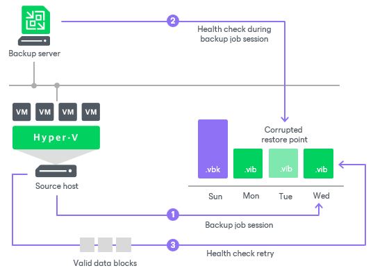

The health check for forward incremental backup chains is performed in the following way:
  1. The health check starts according to the schedule. Depending on the storage type of the repository, the health check procedure can be performed on different infrastructure components:
  • For direct attached storage — on the repository itself.
  • For network attached storage — on the gateway server.
  • For deduplicating storage appliances — on the gateway server.
Consider the following:
  • The gateway server placement may influence the time needed for the health check procedure when using network attached storage and deduplicating storage appliances as repositories. As the health check is performed on the gateway server, we recommend to locate gateway servers as close to the backup repository as possible.
  • The health check runs only after all jobs and operations that process a backup are completed (for example, a backup job, a restore job, synthetic operations with backups and so on). If some of these activities are started, the health check stops.
  • If a health check session does not complete until the next scheduled run, this session will stop and a new session will start according to the schedule.
  • If you add new VMs to a backup job which block data has been processed by the health check, the health check will verify only block data of new VMs and will skip backups of previously added VMs.
  1. The health check calculates CRC values for backup metadata and hash values for VM disks data blocks in the backup file and compares them with the CRC and hash values that are already stored in the backup file.
During the health check, Veeam Backup & Replication verifies the latest restore point in the backup chain (restore point created by the last backup job session). If the latest restore point in the backup chain is incomplete, Veeam Backup & Replication checks the restore point preceding the latest one.
  1. If the health check does not detect data corruption, the backup job session completes in a regular way.
If the health check detects corrupted data, Veeam Backup & Replication completes the backup job with the Error status and starts the health check retry process. The health check retry starts as a separate backup job session.
Depending on the revealed data corruption, Veeam Backup & Replication performs the following actions:
    • If the health check has detected corrupted backup metadata in the full backup file, Veeam Backup & Replication marks the backup chain starting from this full restore point as corrupted in the configuration database. During the health check retry, Veeam Backup & Replication transports data blocks of the whole VM image from the source datastore, creates a new full backup file in the backup repository and saves transported data blocks to it.
    • If the health check has detected corrupted backup metadata in the incremental backup file, Veeam Backup & Replication removes information about this incremental restore point and subsequent incremental restore points from the configuration database. During the health check retry, Veeam Backup & Replication transports new incremental data relative to the latest valid restore point in the backup chain from the source datastore, creates a new incremental backup file in the backup repository and saves transported data blocks to it.
    • If the health check has detected corrupted VM disk blocks in the full or incremental backup file, Veeam Backup & Replication marks the restore point that includes the corrupted data blocks and subsequent incremental restore points as corrupted in the configuration database. During the health check retry, Veeam Backup & Replication transports data blocks from the source datastore. In addition, Veeam Backup & Replication transports data blocks that have changed since the backup job session that has triggered the health check. Veeam Backup & Replication stores these data blocks to the latest restore point that has been created by the current backup job session (session that has triggered the health check retry).

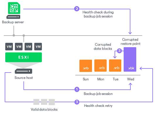

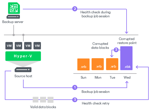

Health Check for Backup Files
Reverse Incremental Backup Chains
In the case of reverse incremental backup chains, the health check always verifies only the latest restore point in the backup chain, which is always a full backup file.
The health check is performed in the following way:
  1. Veeam Backup & Replication verifies the full backup file. It calculates CRC values for backup metadata and hash values for VM disks data blocks in the full backup file, and compares them with the CRC and hash values that are already stored in the full backup file.
  2. If the health check does not detect data corruption, the backup job session completes in a regular way.
    • If the health check has detected corrupted backup metadata in the full backup file, Veeam Backup & Replication marks the whole backup chain (full backup file and preceding reverse incremental backup files) as corrupted in the configuration database. During the health check retry, Veeam Backup & Replication transports data blocks of the whole VM image from the source datastore, creates a new full backup file in the backup repository and saves transported data blocks to it.
    • If the health check has detected corrupted VM disk blocks in the full backup file, Veeam Backup & Replication marks the full backup file and preceding reverse incremental backup files as corrupted in the configuration database. During the health check retry, Veeam Backup & Replication transports data blocks from the source datastore. In addition, Veeam Backup & Replication transports data blocks that have changed since the backup job session that has triggered the health check. Veeam Backup & Replication stores these data blocks to the existing full backup file in the backup repository. Corrupted data blocks that have been replaced with data blocks from the source datastore are stored to an existing reverse incremental backup file preceding the full backup file.

Health Check Retry Mode
If the health check detects corrupted data, the backup job will switch to the Retry mode and will start the health check retry process. During the health check retry, Veeam Backup & Replication transports data blocks of the whole VM image from the source datastore, creates a new full backup file in the object storage repository and saves transported data blocks to it.
If Veeam Backup & Replication fails to fix the corrupted data during all health check retries, you must retry the job manually. In this case, Veeam Backup & Replication will transport the required data blocks from the source datastore, to fix the latest restore point. If the latest restore point in the backup chain is incomplete, Veeam Backup & Replication will attempt to fix the restore point preceding the latest one.
For scheduled jobs, the number of health check retries is equal to the number of job retries specified in the job settings. For jobs started manually, Veeam Backup & Replication performs 1 health check retry.
