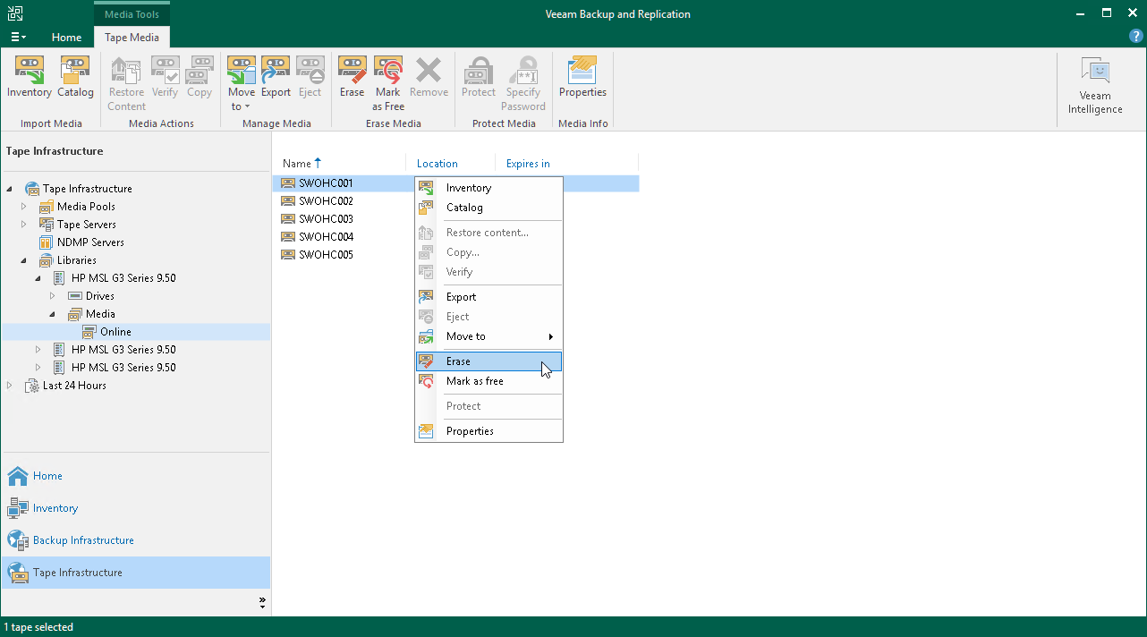

To erase tapes:
  1. Open the Tape Infrastructure view.
  2. Navigate to the list of tapes either under Media Pools or under Libraries > LibraryName node > Media > Online.
  3. Select tapes you want to erase and click Erase on the ribbon. Choose the type of erase and click OK.
    Alternatively, you can right-click selected tapes and select Erase. Next, choose how the tape should be erased and click OK.
You cannot erase protected tapes. To erase such tapes, you need to switch the protection off first.
