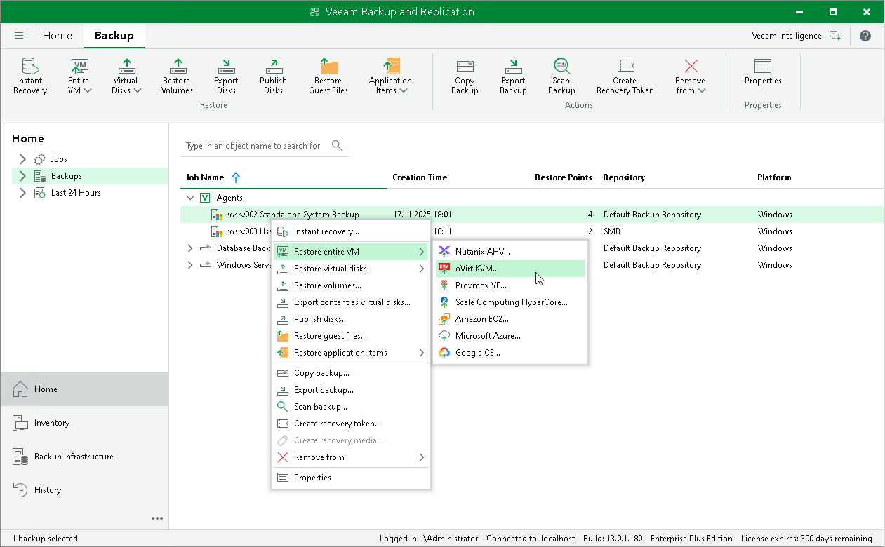

You can use the Veeam Backup & Replication console to restore a Veeam Agent computer as an oVirt KVM VM in your virtualization environment.

The procedure of restore to an oVirt KVM VM for a Veeam Agent computer practically does not differ from the same procedure for a VM. To learn more, see the Performing VM Restore section in the Veeam Backup & Replication user guide.
Restore Veeam Agent Backup to oVirt KVM
