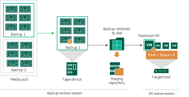

Restore Through Staging Repository
For restoring through a staging repository, Veeam Backup & Replication performs the following steps:
- Veeam starts 2 jobs at background:
- Backup restore job: temporarily restores the backup to the repository.
- VM restore job: restores the VM to the infrastructure.
The jobs start simultaneously. The VM restore job starts and remains pending until the backup restore completes.
- The backup restore job checks the Backup Catalog in the Veeam Backup & Replication database to discover the tapes containing the needed backup. If the tapes are offline, Veeam Backup & Replication prompts the user to insert the required tapes.
- The backup restore job reads the tapes consecutively and copies the backup to the selected staging repository or folder.
- When the backup is copied, Veeam registers it temporarily as an imported backup.
- The backup restore job finishes.
- The VM restore job receives information about the backup restored successfully and launches a standard VM restore process. For more information, see Full VM Recovery.
- When the VM is successfully restored, the VM restore process finishes.
- Veeam deletes the backup from the staging repository and from disk.
