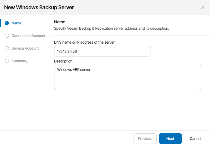

  1. At the Name step of the wizard, specify the following settings:
  1. In the DNS name or IP address of the server field, type FQDN or IP address of the computer where Veeam Backup & Replication server is deployed.
  2. In the Port field, specify a number of the port that you plan to use to connect to the Veeam Backup & Replication server. By default, port 443 is used.
  3. In the Description field, type server description or comments.
Specify Server Address

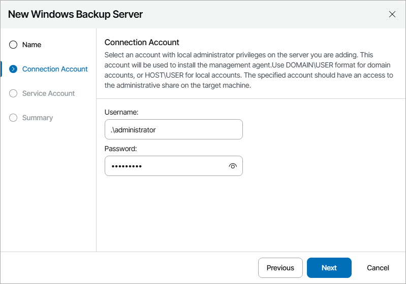

  1. At the Connection Account step of the wizard, specify credentials of a user account with local Administrator privileges on the Veeam Backup & Replication server.
This account will be used to install a Veeam Service Provider Console management agent on the Veeam Backup & Replication server.
The user name must be specified in the DOMAIN\USERNAME format for domain accounts, or HOST\USERNAME format for local accounts.
Specify Connection Account Credentials

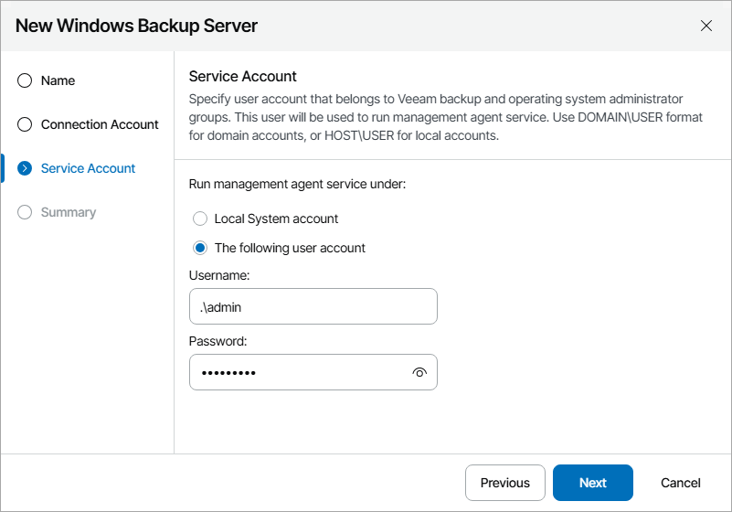

  1. At the Service Account step of the wizard, specify the account that will be used to run a management agent on the Veeam Backup & Replication server:
  • Select Local System account, if you want to run management agent under the Local System account of the machine on which Veeam Backup & Replication server is installed.
  • To use a different account, select The following user account and specify the credentials of a user account with Veeam Backup Administrator privileges on Veeam Backup & Replication server and Local Administrator privileges on the machine on which Veeam Backup & Replication server is installed.
For details on Veeam Backup & Replication users, roles and privileges, see section Managing Users and Roles of the Veeam Backup & Replication User Guide.
Specify Service Account Credentials
