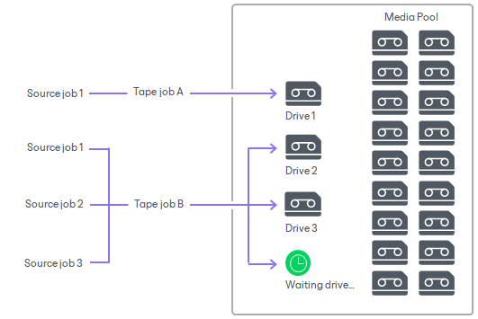

Example 1. Processing Two Tape Jobs with Multiple Source Jobs
  • You set the maximum number of drives to three.
  • Tape job A has one source job; tape job B has three source jobs. Both tape jobs start at the same time.
Tape job A occupies drive 1. Tape job B occupies two other available drives and processes two source jobs. Tape job A finishes and releases drive 1, the third source job from tape job B occupies drive 1.
The order in which VMs are queued for processing is defined by the schedule configured for running tape jobs and the order of source jobs within each tape job. Within each source job, VMs are processed in alphabetical order.

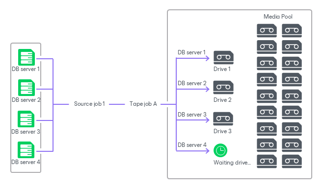

Example 4. Processing One Plug-In to Tape Job with Multiple Database Servers
For plug-in backup to tape, Veeam Backup & Replication processes backups of each database server separately to ensure that a central backup job metadata file (.VACM) is always written to tape.
In the example, the following settings apply:
  • The source plug-in backup job 1 processes four database servers.
Tape job A starts and occupies all three available drives. It writes backups for each separate database server by a separate drive. After tape job A finishes writing one of the database server backups and releases one of the three available drives, it occupies this drive with writing DB server 4.
