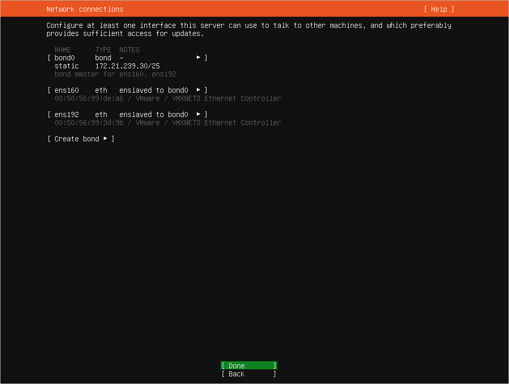

  6. At the Network connections step of the installation wizard, do the following:
  • If you have several network interface cards, create a bond to provide the network failover in case of connection issues. For the bond mode, select one of the following options:
    • balance-rr (if you use EtherChannel without LACP)
    • 802.3ad (if you use EtherChannel with LACP)
    • active-backup (for other configurations)
Example:
Installing Ubuntu Linux Server

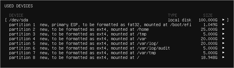

  3. At the Storage configuration step of the installation wizard, follow recommendations from CIS Benchmarks for Ubuntu Linux 20.04 LTS STIG for partitioning.
For the operating system, use the ext4 file system. Example:

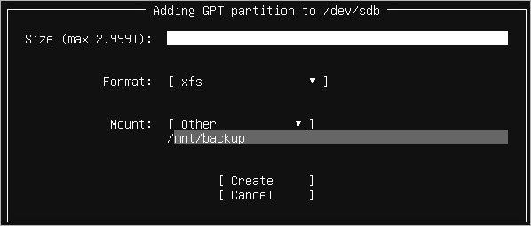

For the backup data, use the XFS file system. Example:
