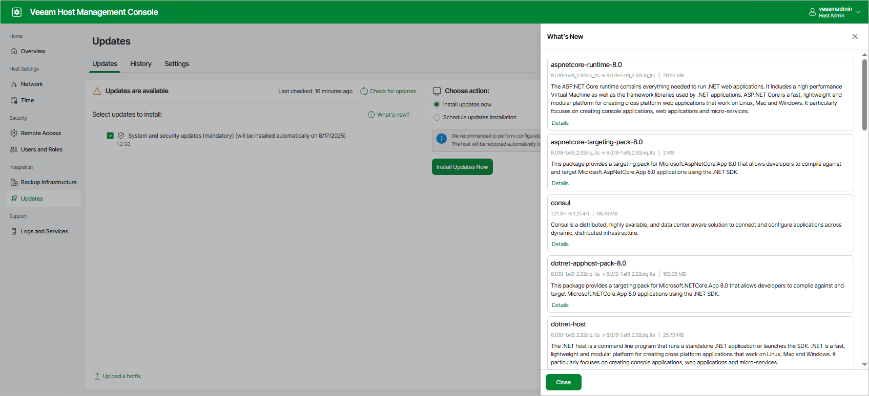

Installing Updates Manually
To install updates manually, perform the following steps:
  1. Log in to the Veeam Host Management console installed on the backup server. If you want to update the backup infrastructure component that uses custom update configuration, log in to the Veeam Host Management console installed on this component.
  2. In the management pane, click Updates.
  3. On the Updates tab, select updates that you want to install. To view detailed information about changes included in updates, click What's new?. For optional updates, a license agreement is also displayed if applicable.
  4. Select the action:
  • To install updates immediately, click Install Updates Now and confirm the operation.
  • To schedule update installation, set up the schedule and click Schedule Updates.
