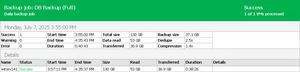

Veeam Backup & Replication displays the following counters in reports:
  • The Success, Warning and Error counters show how many workloads were processed with the Success, Warning and Error statuses.
  • The Start time and End time counters show when the job started and completed.
  • The Duration counter shows the time from the job start till the current moment or job end.
  • The Total size counter shows the provisioned size (the maximum configured size) of all workload disks in the job.
  • The Data read counter shows the amount of data read from the datastore before compression and deduplication. The value of this counter is typically lower than the value of the Total size counter. Veeam Backup & Replication reads only data blocks that have changed since the last job session, processes and copies these data blocks to the target.
  • The Transferred counter shows the amount of data transferred from the source side to the target side after applying compression and source-side deduplication. This counter does not directly indicate the size of the resulting files. Depending on the backup infrastructure and job settings, Veeam Backup & Replication can perform additional activities with data: perform target-side deduplication, decompress data prior to writing the file to disk, and so on. The activities can impact the size of the resulting file.
  • The Backup size counter shows the resulting backup file size.
  • The Dedupe counter shows the deduplication level.
  • The Compression counter shows the compression level.
In the Details section, you can see similar counters for each workload the job processed.
A synthetic full backup that is part of an incremental backup session is synthesized directly on the backup repository. Therefore, the Transferred and Backup size counters do not include data processed during the synthetic backup. They cover only data processed during the incremental run. Besides, the report header for such a backup does not have the (Full) mark as Veeam Backup & Replication considers it incremental. For more information, see the Synthetic Full Backup section.
