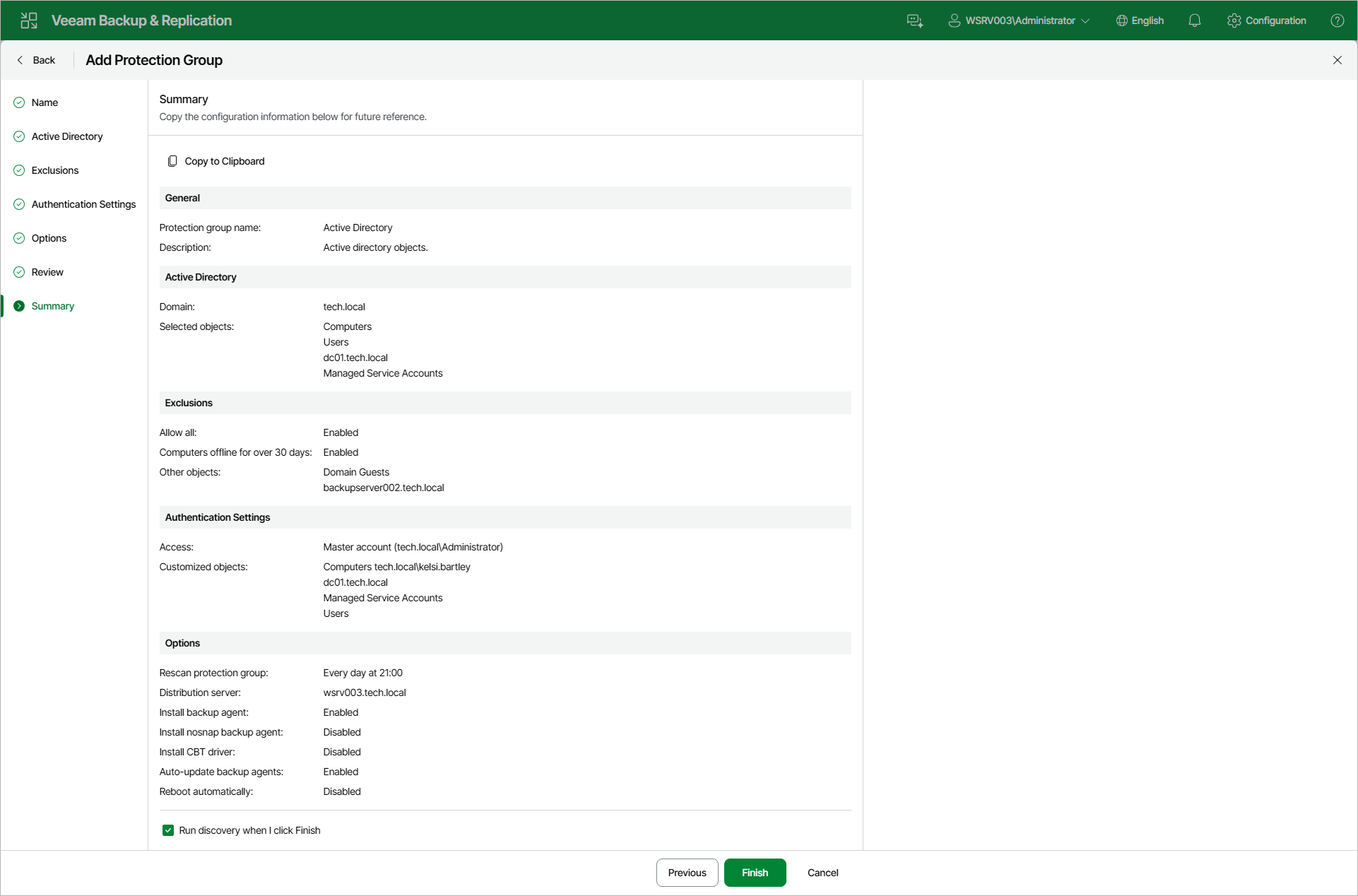

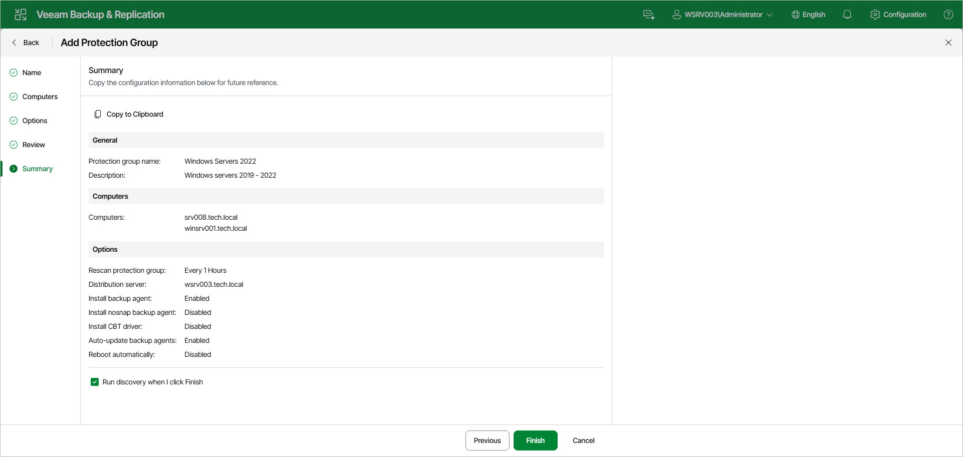

At the Summary step of the wizard, complete the protection group configuration process.
  1. Review information about the created protection group.
  2. If you want to copy the configuration information for future reference, click Copy to Clipboard.
  3. To start the rescan job after you close the wizard, make sure that the Run discovery when I click Finish option is selected.
If you want to perform computer discovery later, you can clear the Run discovery when I click Finish check box. In this case, the rescan job will start automatically upon the defined schedule. You can also start the rescan job manually at any time you need. To learn more, see Starting Protection Group Discovery.
  1. Click Finish to close the wizard.
Finish Working with Wizard
