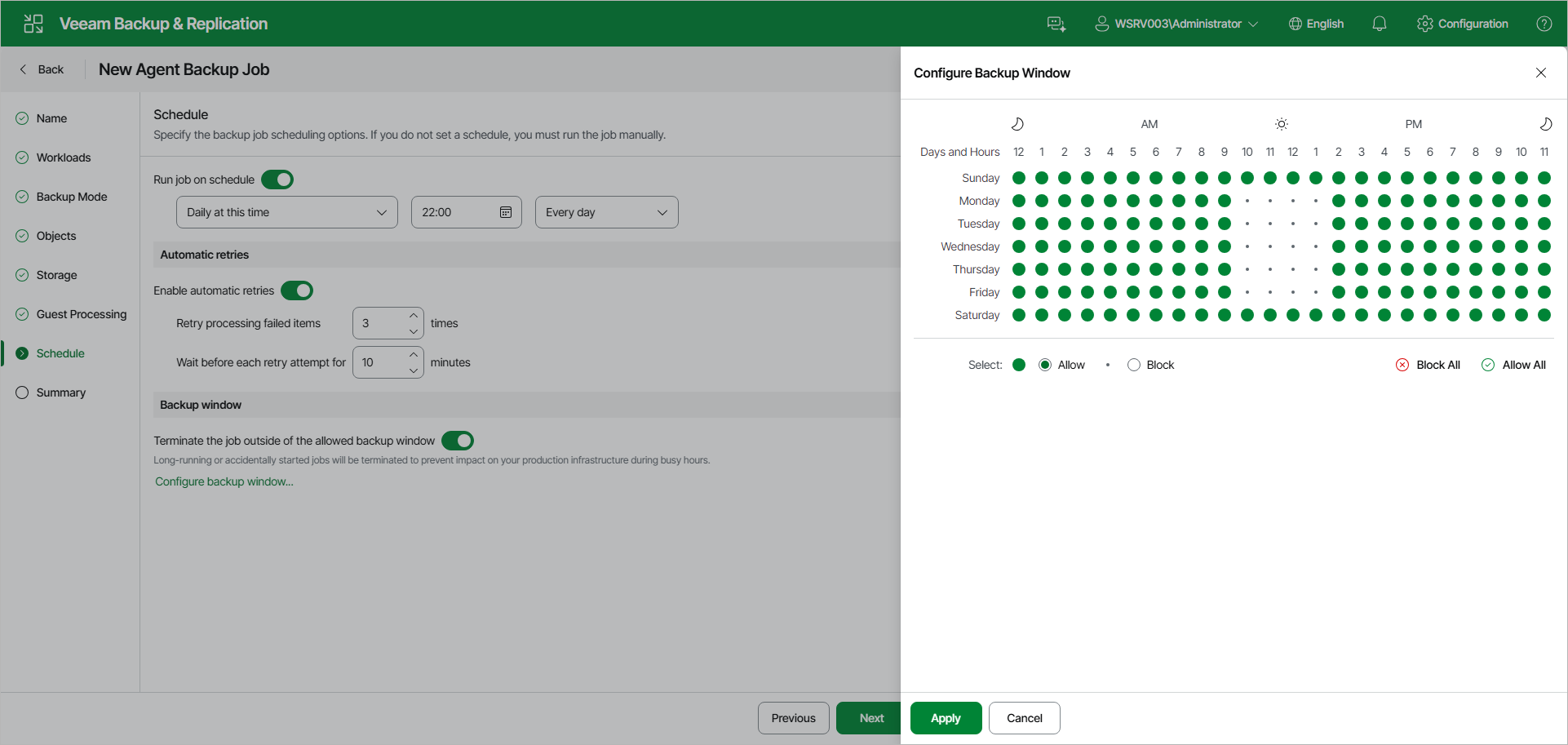

At the Schedule step of the wizard, specify the backup job scheduling options. If you do not set a schedule, you must run the job manually.
To specify the job schedule:
  1. Turn on the Run job on schedule toggle. If the toggle is off, you will have to start the backup job manually to create backup.
  2. Define scheduling settings for the job:

  1. In the Automatic retries section, turn on the Enable automatic retries toggle if you want Veeam Backup & Replication to attempt to run the backup job again if the job fails for some reason. In the Retry processing failed items field, specify the number of attempts to run the job. In the Wait before each retry attempt for field, specify the time interval between attempts in minutes. If you select continuous backup, Veeam Backup & Replication retries the job for the defined number of times without any time intervals between the job runs.
NOTE
The automatic retry does not start if you run the backup job manually. In this case, you can manually retry the backup job. To learn more, see Retrying Veeam Agent Backup Job.
  1. In the Backup window section, define the time interval within which the backup job is allowed to run. The backup window prevents the job from overlapping with production hours and ensures that the job does not impact performance of your server. To set up a backup window for the job:
  1. Turn on the Terminate the job outside of the allowed backup window toggle and click Configure backup window.
  2. In the Configure Backup Window window, use the time table to define the allowed and blocked hours for the backup job:
  • The green area indicates the allowed backup window — the hours when the backup job is allowed to run.
  • The white area indicates the blocked window — the hours when the backup job is not allowed to run. If the Terminate the job outside of the allowed backup window toggle is on, a job that is still running when the blocked window starts is automatically terminated.
  • To change the state of individual cells, next to Select, select Allow or Block, and then click or drag over the cells in the time table. To apply the same state to all cells, click Allow All or Block All.
If the job exceeds the allowed window, it will be automatically terminated. In this case, data transport and backup chain transformation processes are stopped. Keep in mind that this behavior differs from a VM backup job where backup window affects data transport process and health check operations only.
