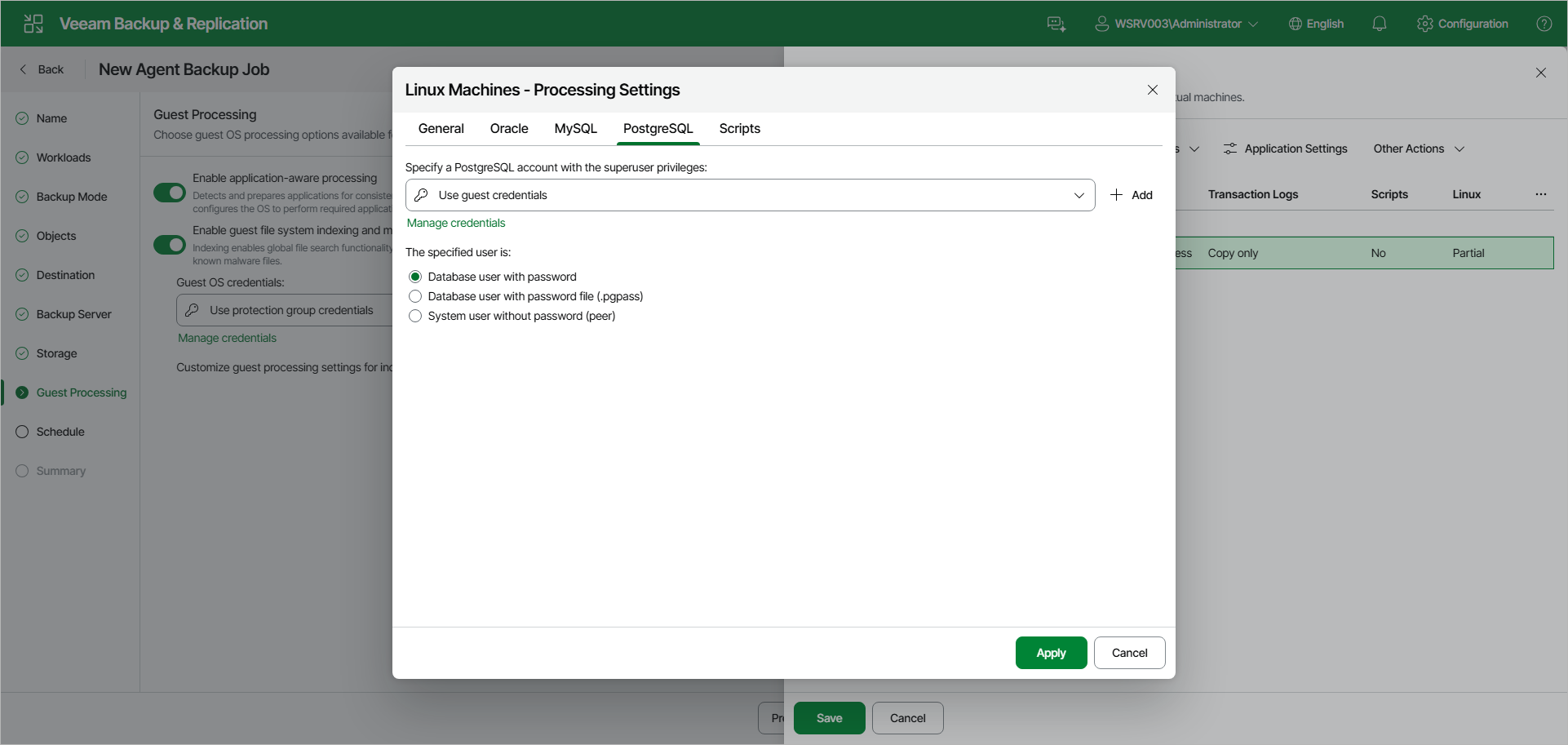

To specify how Veeam Agent for Linux must process a PostgreSQL database system:
  1. At the Guest Processing step of the wizard, make sure that the Enable application-aware processing toggle is on.
  2. Click Customize.
  3. In the Customize Guest Processing Settings window, select the check box next to the protection group or individual computer and click Application Settings on the toolbar.
  4. In the Processing Settings window, on the General tab, make sure that Require successful processing or Try application processing, but ignore failures is selected in the Applications section.
  5. Open the PostgreSQL tab.
  6. From the Specify a PostgreSQL account with the superuser privileges drop-down list, select a user account that Veeam Agent for Linux will use to connect to the PostgreSQL database.
If you have not set up credentials beforehand, click the Manage credentials link or click Add on the right to add credentials.
By default, the Use guest credentials option is selected. With this option selected, Veeam Agent for Linux will connect to the PostgreSQL database under the account specified in the Guest OS credentials drop-down list at the Guest Processing step of the wizard.
Keep in mind that if you plan to select the peer authentication method at step 7 of this procedure, you can add a user account in the Credentials Manager without specifying the password for the account.
  1. Under The specified user is, select how Veeam Agent will connect to the PostgreSQL database:
  • Database user with password
  • Database user with password file (.pgpass)
  • System user without password (peer)
