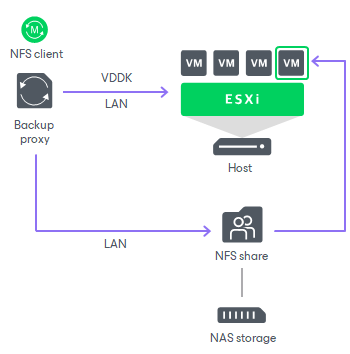

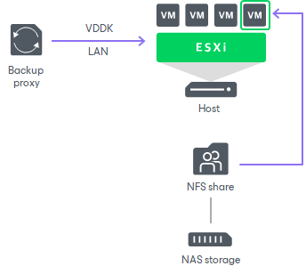

The Direct NFS access mode provides an alternative to the Network mode. When Veeam Backup & Replication processes VM data in the Network mode, it uses VMware VDDK to communicate with the ESXi host. This produces additional load on the ESXi host.
Direct NFS Access
In the Direct NFS access mode, Veeam Backup & Replication bypasses the ESXi host and reads/writes data directly from/to NFS datastores. To do this, Veeam Backup & Replication deploys its native NFS client on the VMware backup proxy and uses it for VM data transport. VM data still travels over LAN but there is no load on the ESXi host.
