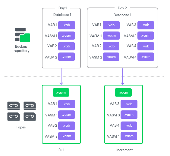

  • The restore points for Veeam Plug-In backups to tape are created in the following way:
  • The full backup processes the entire repository backup chain — it copies all closed plug-in backup files existing at the time the backup job runs.
  • The incremental backup copies any new closed plug-in backup files created from the time of the previous backup to tape job run.

How Veeam Plug-In Backup to Tape Works
For Veeam Plug-In backup to tape job, Veeam Backup & Replication performs the following operations:
  1. Veeam Backup & Replication checks the source backup repository for backups created by Veeam Plug-Ins for Enterprise Applications.
  2. Depending on the type of the restore point, the following scenarios are used:
  • If it is a first job run or a scheduled virtual full backup, Veeam Backup & Replication generates a central metadata file (VACM) and writes it to the tape. Then Veeam Backup & Replication copies all closed plug-in backup files in the source repository: backup data files (VAB) and their backup metadata files (VASM).
  • If it is an incremental backup run, Veeam Backup & Replication generates a central metadata file (VACM) and writes it to the tape. Then Veeam Backup & Replication copies any new closed plug-in backup files (VAB and VASM) created from the time of the previous backup to tape job run.
The data transfer process is done using Veeam Data Movers: the source Data Mover retrieves data from the source repository and target Data Mover sends data to tape.
