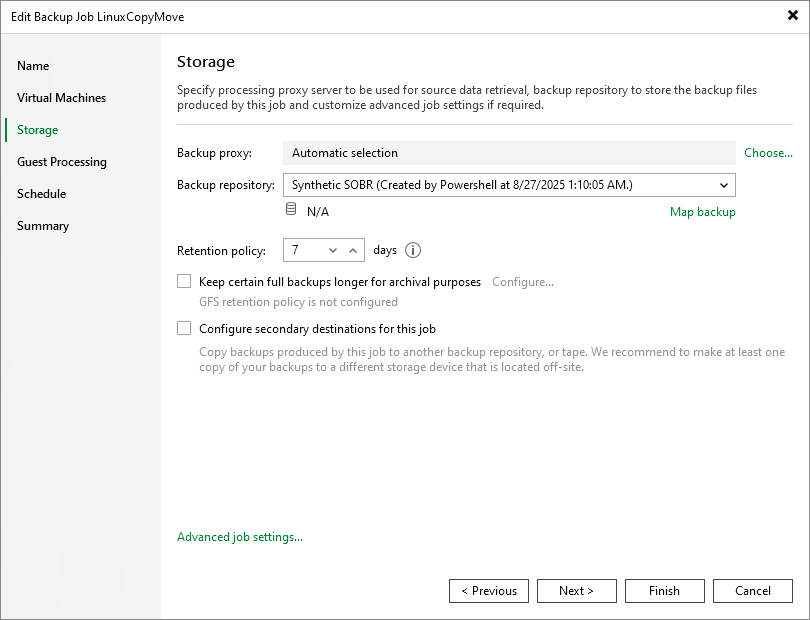

  3. Go to the Jobs node and edit the jobs associated with the SOBR. At the Storage step of the wizard, select the SOBR from the backup repository list. Select Map Backup and map the job to the corresponding imported backup. Finish the wizard to apply changes. Repeat this process for each backup job using the SOBR.
