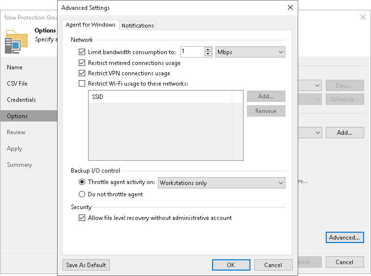

To specify settings for Veeam Agent for Microsoft Windows:
  1. At the Options step of the wizard, click Advanced.
  2. If you want to limit bandwidth consumption for Veeam Agent backup jobs, on the Agent for Windows tab, in the Network section, select the Limit bandwidth consumption to check box. Then specify the maximum speed for transferring backed-up data from the Veeam Agent computer to the target location.
  3. By default, backup over metered connections is disabled for Veeam Agent for Microsoft Windows. Veeam Agent automatically detects metered connections and does not perform backup when your computer is on such connection. To enable backup over metered connections, clear the Restrict metered connections usage check box.
Veeam Agent for Microsoft Windows SettingsNOTE
You must specify which connections are metered in Microsoft Windows. To learn more, see this Microsoft webpage.
  1. If you want to disable backup over VPN connections, select the Restrict VPN connections usage check box. Veeam Agent for Microsoft Windows will automatically detect VPN connections and will not perform backup when the Veeam Agent computer is on such connection.

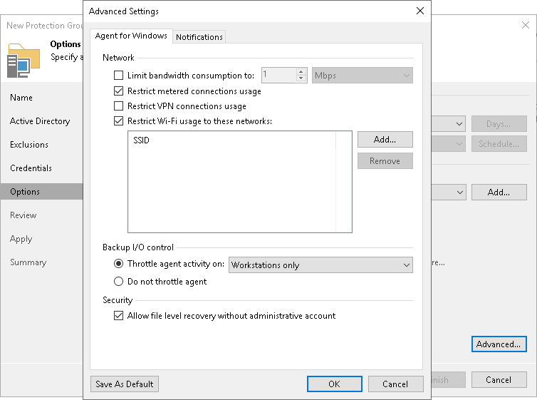

  2. If you want to restrict usage of wireless networks for Veeam Agent running on Microsoft Windows workstations, do the following:
  1. Select the Restrict Wi-Fi usage to these networks check box and click Add.
  2. In the Wi-Fi Network window, specify the SSID of the Wi-Fi network over which Veeam Agent will be allowed to perform backup, and click OK.
Veeam Backup & Replication will add the specified network to the list of allowed Wi-Fi networks. Backup over other wireless networks will be disabled for Veeam Agent.
Veeam Agent for Microsoft Windows Settings TIP
If you want to restrict usage over any wireless networks, select the Restrict Wi-Fi usage to these networks check box and do not add any networks to the list.
  1. If you want to throttle Veeam Agent activities during backup, in the Backup I/O control section, make sure that the Throttle agent activity on option is selected. Then select the type of computers on which to throttle Veeam Agent backup activities: Workstations only, Servers only or All hosts.
If you do not want to throttle backup activities for Veeam Agent, select Do not throttle agent.
  1. In the Security section, select the Allow file level recovery without administrative account check box. With this option enabled, Veeam Agent computer users who work under accounts that do not have administrative privileges will be able to perform file-level restore on the Veeam Agent computer.
In this case, access rights to files and folders are managed by the OS of the Veeam Agent computer. If a user cannot access a folder in its original location, the user cannot browse or restore the content of this folder either.
To learn more, see Restoring Files from Backup without Administrator Privileges.
  1. To enable remote bare metal recovery on protected computers, select the Allow virtual recovery partition creation check box. Veeam Agent for Microsoft Windows will create a hidden recovery environment on each protected computer that you can boot remotely from the Veeam Backup & Replication web UI to restore the computer without physical access.
To learn more, see Restoring from Veeam Recovery Media Remotely.
