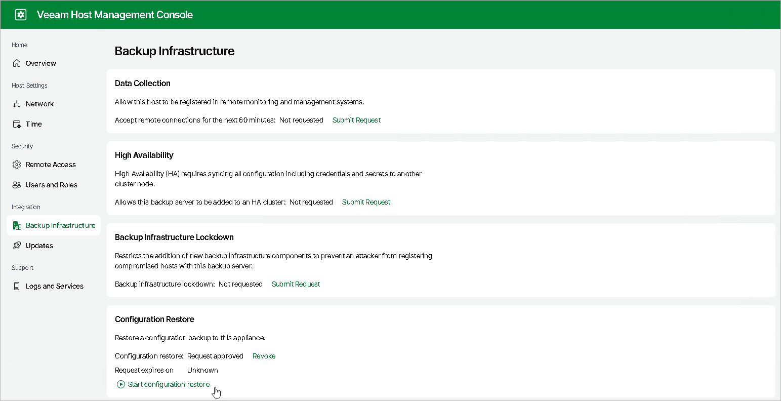

  1. Log in to the Veeam Host Management web UI.
In the browser address bar, enter the following URL, replacing <VBR-Host-IP> with the hostname or IP address of your target Veeam Backup & Replication server:
https://<VBR-Host-IP>:10443/
  1. In the Configuration Restore section, click Submit Request to acquire permissions:
  1. In the Configuration Restore section, click Start configuration restore.

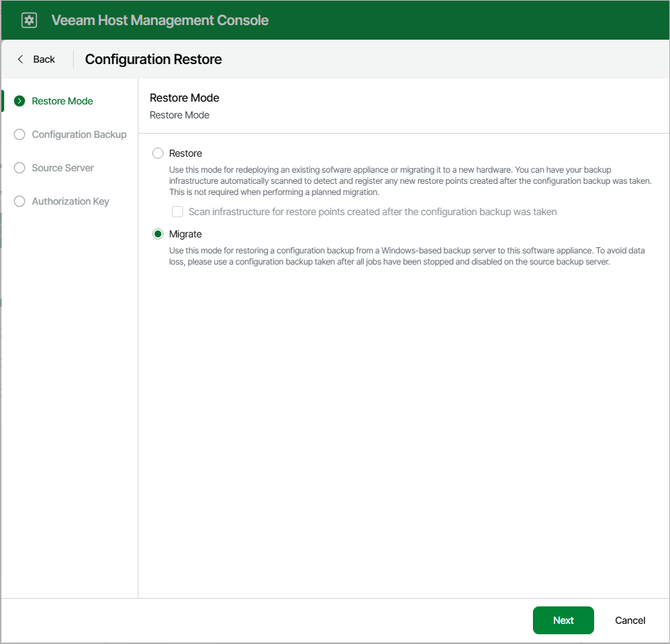

Step 2. Select Restore Mode
At the Restore Mode step of the wizard, select Migrate.

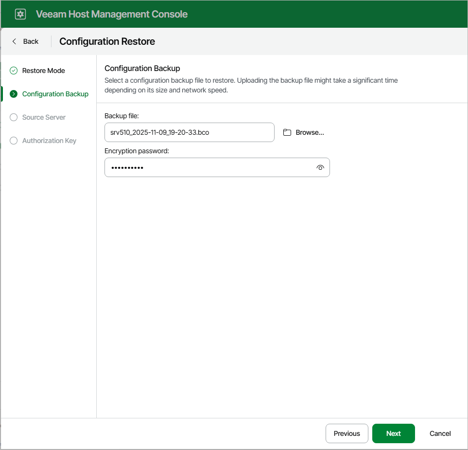

Step 3. Select Configuration Backup
At the Configuration Backup step of the wizard, click Browse to select a configuration backup file to restore and specify the backup encryption password.
Migrating Veeam Backup & Replication to Linux-Based Backup Server

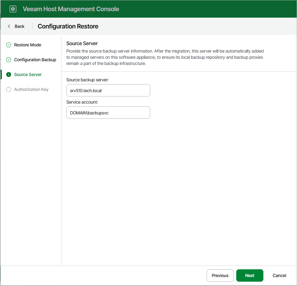

Step 4. Specify Source Backup Server
At the Source Server step of the wizard, specify the source backup server and service account.
After the migration, this server will be added to managed servers on the target software appliance. This ensures that its local backup repository and backup proxies remain a part of the backup infrastructure.

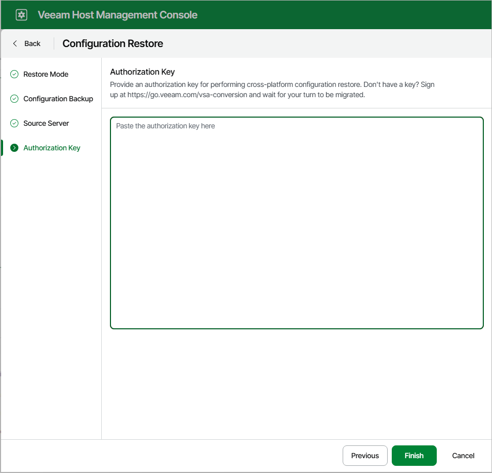

Step 5. Specify the Authorization Key
At the Authorization Key step of the wizard, specify the authorization key you received from the Veeam Support.
