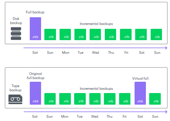

The virtual full backup allows you to transform backup chains created by source backup and backup copy jobs to save them to tapes. Unlike disk backups, tape archives are static: tape jobs cannot rebuild backups once they are written to tape. Also, if the source job has forever forward incremental backup chain configured, then the tape archive will have one full backup and an endless chain of increments all of which would be required for restore. To adapt such backup chains to tapes, Veeam Backup & Replication uses the virtual full backup.
The virtual full backup mechanism creates a periodic synthesized full backup on tape. The periodic full backups split the backup chain into shorter series of files that can be effectively stored to tapes. Each series contains one synthesized full backup and a set of increments. Such series are convenient for restore: you will need to load to the tape device only those tapes that are part of one series.
The virtual full backup does not require additional repository disk space: it is synthesized directly on tape on the fly when the tape job runs. To build such full backup, Veeam Backup & Replication uses backup files that are already stored in the backup repository.
