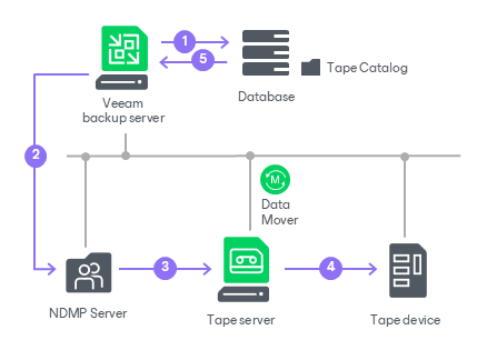

For file backup to tape jobs for standalone NDMP servers, Veeam Backup & Replication backs up the file system state of entire NDMP volumes. While this type of backup operates at the file level, you can back up or restore only whole NDMP volumes.
During a job run, Veeam Backup & Replication performs the following operations:
- Veeam Backup & Replication checks the backup chain to determine whether to run a full or an incremental backup.
- Veeam Backup & Replication instructs the NDMP server to create a dump of the file system state relative to the selected backup level.
- For incremental backups, Veeam Backup & Replication reads the dump data from the NDMP server through the gateway server to detect if any data has been modified.
- Veeam Backup & Replication connects to Veeam Data Movers and starts the data transfer process from the source NDMP server through the gateway server to the tape server and the tape drive.
In case the NDMP server has automatic gateway server selection enabled, the tape server is automatically added to the list of available gateway servers for this backup session and is used by default.
- Veeam Backup & Replication records the backup in the configuration database so that subsequent incremental runs can reference the current backup chain.
