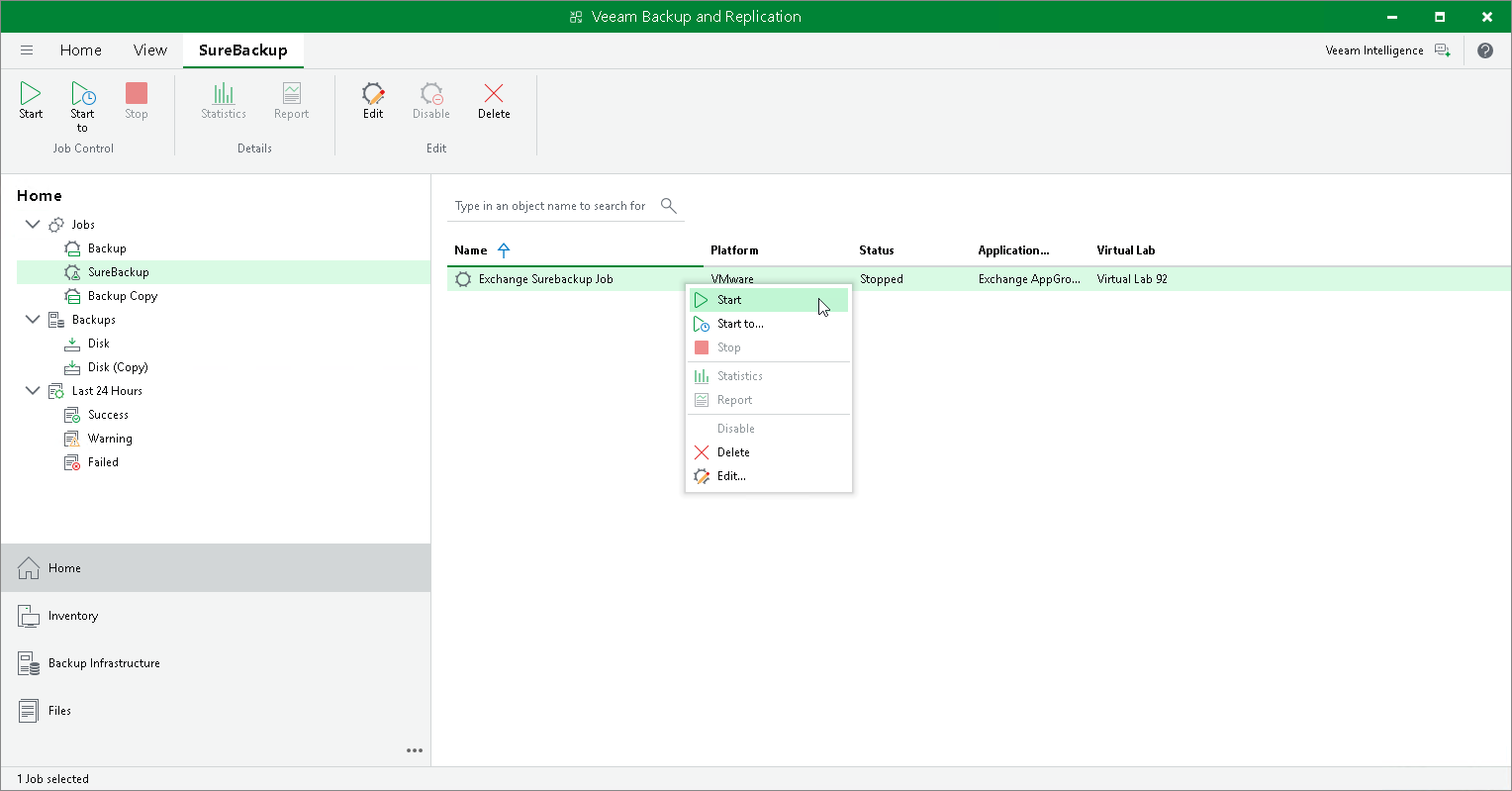

To start VMs in the On-Demand Sandbox, run the SureBackup job:
  1. Open the Home view.
  1. In the inventory pane, select SureBackup.
  2. In the working area, right-click the configured SureBackup job and select Start or Start to.
Veeam Backup & Replication will start the virtual lab and power on VMs from the application group in the virtual lab. You will be able to connect to VMs and perform tests for them.
