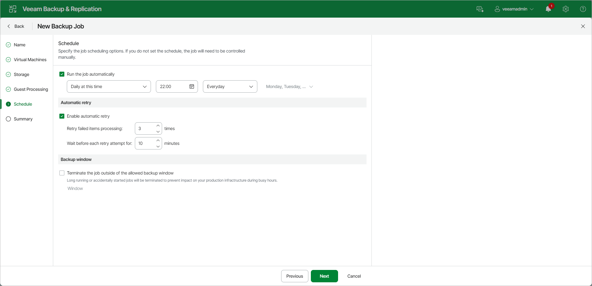

Step 9. Define Job Schedule
At the Schedule step of the wizard, select to run the job manually or schedule the job to run on a regular basis:
  1. To run the job automatically, set the Run the job automatically toggle to On. If you do not do it, you will have to start the job manually.
  2. From the list, select the required schedule option:
    • Daily at this time. The job will run at a specific time daily, on weekdays or with specific periodicity. In the fields on the right of the radio button, specify the time and required days.
    • Monthly at this time. The job will run once a month on specific days. In the fields on the right of the radio button, specify the time and required days and months.
    • Periodically every. The job will run repeatedly throughout a day with a set time interval.
To configure the period and allowed hours, do the following:
  1. In the field on the right of the list field, select the necessary time unit. If you select Continuously, a new job session will start as soon as the previous job session finishes.
  2. If you want to specify the permitted time window for the job, click Schedule. In the Configure Backup Window window, specify the schedule.

  1. In the Automatic retries section, set the Enable automatic retries toggle to On, if Veeam Backup & Replication must attempt to run the job again for workloads whose processing failed for some reason. Enter the number of attempts to run the job and define time spans between them.
If you select continuous schedule for the job, Veeam Backup & Replication will retry the job for the defined number of times without any time intervals between the job sessions.
  1. In the Backup window section, specify a time interval within which the job must be completed. The backup window prevents the job from overlapping with production hours and ensures the job does not provide unwanted overhead on your production environment.
To set up a backup window for the job:
  1. Set the Terminate the job outside of the allowed backup window toggle to On and click Configure backup window.
  2. In the Configure Backup Window window, define the allowed hours and prohibited hours for the job. If the job exceeds the allowed window, the job will be automatically terminated.
