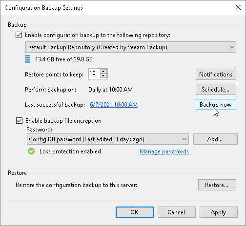

To create a configuration database backup manually, perform the following steps:
  1. From the main menu of the Veeam Backup & Replication console, select Configuration Backup.
  2. Make sure that the Enable configuration backup to the following repository check box is selected.
  3. From the list of repositories, select a backup repository in which the configuration backup must be stored.
  4. Click Backup now.
Migrating Configuration Database to Another SQL Server
Loss protection disabled warning is safe to ignore if you do not have Veeam Backup Enterprise Manager installed, your backup server is not registered with Veeam Backup Enterprise Manager server, or your system administrator chose not to enable loss protection functionality.

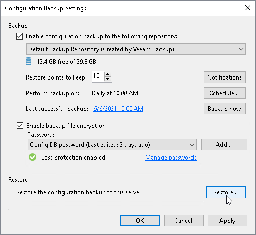

Before you start the restore process, check the prerequisites. To restore the configuration database, perform the following:
  2. In the Restore section, click Restore.

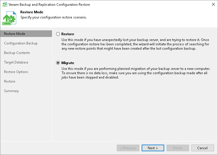

  1. At the Restore Mode step of the Veeam Backup & Replication Configuration Restore wizard, select Migrate.
  1. Complete the wizard as described in section Restoring Configuration Database.
